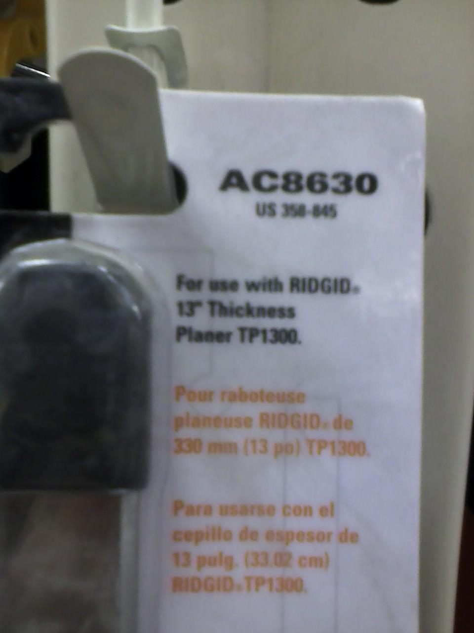

          Good catch... when you look at the photo that Toolguy posted, it gives the same number that I referred to. They are the 2-blade "AC8630" packs which fit the Ridgid and the Ryobi 1300 models.
          That is not to say of course that there's not a mixup in that particular store, as I've seen that happen before. IIRC, I think both blade styles share the same SKU#, which makes it confusing.

            just to clarify my post on these blades, here is a pic of the package description:
