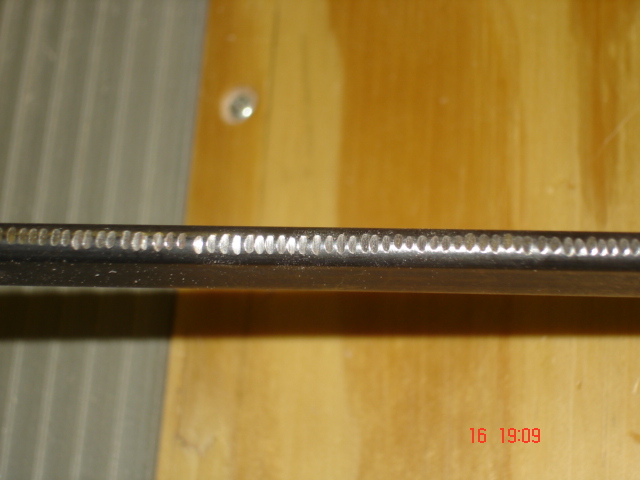

      If I happened to tell my wife, who is the one that gave these claps to me as a Christmas present, that they are as worthless as the nipples on a boar hog it would be an awfully cold winter.
      The better part of valor is to use them and let her see them being used. In order to use them they need some modification.

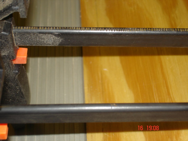

        Pictures of the simple modification:

              Dal, that was a very smart modification! I don't have a triangular file, but I will keep my eye out for one. I didn't realize the top side was where the plate was engaging. Your fix addresses the slippage, which to be honest after wiping off the storage oil, I have never had one slip, all have failed me when clamping with the trigger handle's pivot point shearing off.
              Again, these are cheap tools, but with a few minutes work and next to nothing investment they can become serviceable.
                Definitely a great diy improvement of the HF clap, Dal

                    I score both the top and the bottom because the clamp uses both sides for leverage. The problem I have with the scoring is that my hands aren't real steady so I can't get the lines really close together.
                    Instead of a triangle file I used the dremel tool on one, but it seems the disks are too thick to make that fine a cut. If I could find thinner blades it might work better.

                      When I get some time, I want to try out your improvement. 20 sides is a bit of work, I wonder if perhaps a clamp rest with indexing guide would make the work go faster.. :-) Some time in the next year, maybe

                        I did mine when I couldn't do anything else.... like when waiting for the finish to set up, or when getting some quiet time with a cold adult beverage.
