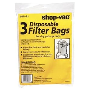

                  Originally posted by Shep
                  Anyone have any experice with this one from Rockler? I like the idea of larger capacity and on wheels.
                  I have no personal experience, but based on the design it should work OK for everything but fine dust. If you use one of these paper pre-filter bags in your shop-vac, you should be good to go.
                  The big advantage of a well-designed "true" cyclone-style separator is that they collect *everything*, not just the bigger pieces.
