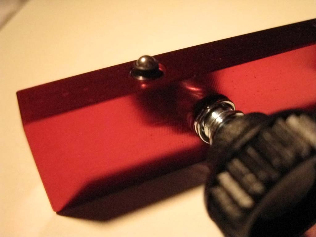

              For those of you that got or have had one.. how well does the bar fit in the miter slot? Can it be adjusted so that there is absolutely no slop as with an Incra miter gauge? I live about 12 miles from P'tree and might consider one but without a magnet attached to the bar I see no way that it can be used on a jointer and planer. Then again.. you could lay it flat on the table and check to see if the blades are even all the way across by simply sliding it across while holding it flat.

                I still haven't gotten mine Sarge but according to the video there are spring plungers that push the bar towards side of miter slot closest to the blade side. See 1:00 mark.
                http://www.youtube.com/watch?v=fDHgo2uk3E4

                      there are at least 2 of the spring ball sockets that can be adjusted to get a good fit. Hope they line up ok on my Grizzly G0691. It has the T slot at the bottom. Jim.
                        Mine just got here a few minutes ago. (On the UPS truck for 14+hrs for delivery) I haven't put it in a miter slot yet. Jussi is correct, there are two spring loaded, adjustable, slack-taker-outers on each end. They are like miniature bullet catches. They are adjusted from the other side of the bar with a small screwdriver. I extended one out for the photo below.
                        One might be able to drill the bar for some rare earth magnets for use on a jointer or planer. I don't think it would work all that well as the bar is only 3/4" wide and the weight and/or force from the dial indicator would be about the long axis of the bar. Without an indicator and just sitting on my desk I can't hold it in a very stable manner if I apply even a light force on the cross bar.
