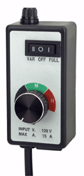

May I ask please what you meant by adding "an outboard VS switch though" and if it is feasible for a DIYer? Thank you.Comment
wd4lc, you can purchase a separate speed control for NON variable speed routers from several places including harbor freight:
http://www.harborfreightusa.com/usa/...bCategoryName=Comment

Thanks geeoh. Looks like plug and play (easy enough) and less expensive than I would have thought. I had no idea such a thing existed.wd4lc, you can purchase a separate speed control for NON variable speed routers from several places including harbor freight:
[ATTACH]11961[/ATTACH]

Also, would the 5615-1.75 accompanied with that exterior variable speed control be just as good (despite the lack of horsepower)...meaning does the exterior variable speed switch somehow negatively impact the router over time?

I personally would avoid the external speed control. It would probably be fine if you used the router table mounted permanently but... I prefer to keep a hand held operation as simple as possible considering I already have to find a way to get a dust hose to the router and avoid the hose catching corners of the work-bench... and the same with the electrical cord.
