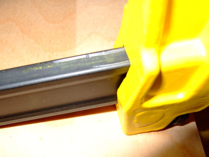

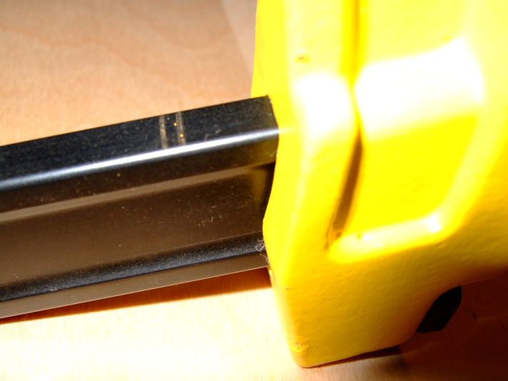

                      I took a closer look at (and included photos of) Stanley clamps of mine that don't slip vs. one that does. In the photo of a clamp that does not slip, you can see where the clutch plates "bit" evenly into the bar across the entire edge of the bar. Further tightening the clamp just causes the clutch plates to "bite" more deeply into the bar. In the photo of a clamp that slips, you can see where the clutch plates just bite on the outside edges of the edge of the bar, so that there is not much supporting metal backing up the "bites". Further tightening of the clamp seems to cause the clutch plates to shear off material from the ouside edges of the bar allowing the jaws to "slip". Close examination of the bar with the slipping seems to show that its edges are slightly concave, which explains why the clutches only bite into the bar at the outside edges. Taking the above into account, I can see where using a mill file in a "draw filing" manner might remove the concavity of the edges of the bar, allowing the clutch plates to bite into the bar evenly across the edge. Of course, this is a bit of work depending on how much metal you remove. And I suppose that if you remove to much metal you might alter clutch plate/bar assembly geometry to the point where the jaws might slip for some other reason. I have not tried this modification myself as I am curious to see what response if any you get from Stanley.

                        I'll check mine for the concavity issue. Looks, from your excellent photos, like that might be the problem. BTW, is the bar the same on both edges? Could you put a digital gauge to it and see how the dimension compare? Looks to me that the defective one has slimmer top and bottom "cross bars".
                        - David
