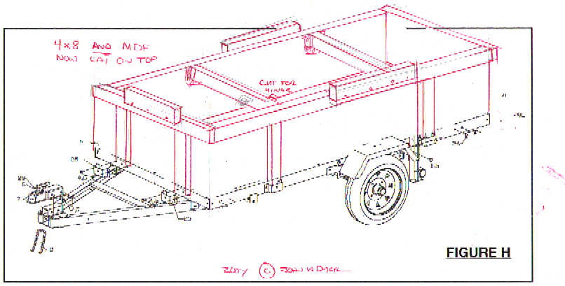

        I love mine. We are a two car - no pickup family, so I had a hitch put on my Taurus. I use it for dump runs, wood buys, garage sales etc. One tip, if you build a wood wall with vertical 2x4 in the holders and plywood on the inside a 4x8 sheet will not lie flat. Also the hinge mechanism will damage sheet goods laid on the floor. So what I did was to run two 2x4 on joint hangers across the center even with the top rail and then mounted three 24” long 2x4 outside of the rim to form a stop ( I will try to take a pic tonight) This lets me stack sheet goods on the top fully supported and slide 2x4 down below. The hinge/folding thing really is sort of lame, but if you had to hide the trailer (condo associations etc) it does give you a smaller footprint to roll into the garage. Also the wires will come loose from the little clip thingies. I am going to rewire it so I can see the wires and where they will not be pinched by the strap hooks I use. I’ve never bottomed out the springs and I hauled a lot of ceramic tile. I need to get a pallet of sod and that’s a full 1500 -2000 lbs so I guess I will have to do two trips. Plan on a full 6-8 hours to put this together if working solo, a second pair of hands will speed it up.

                I could not get to taking the trailer pic yet, so here is a crude sketch to give you a better idea of what I did.

                    I like that idea Ex-Yankee, I might do it on mine one day. You should be able to fit MDF sheets (49x97) on there right?

                        Its measures something like 51" between the stop blocks. One unforeseen benefit was that its easier to slide the sheetgoods of the top deck onto sawhorses than from the bottom of the trailer.
