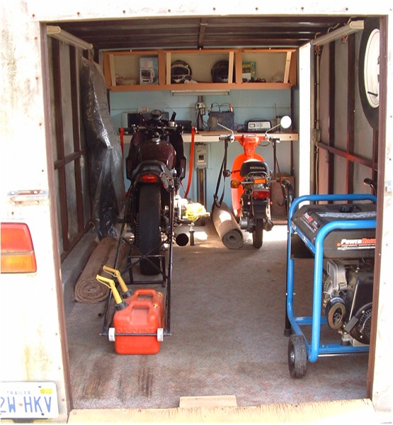

    This was framed with 14ga square tubing with my welder.
    Biggest problem I had was waiting for it to cool down and recycle. It tends to over heat and shut down if you try to use it too long at a time.
