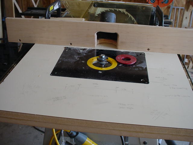

      The plate I got from Woodcraft looks just like that one in the picture, rings and all.
      My only complaint so far is the rings -- like was mentioned above, a much larger set of rings would be better. The fit is good with some bits but pretty lacking on others. A 1/2" roundover bit means you remove the smallest ring and so you have a pretty big gap there.

          HF Router Table Insert first impressions
          I received the 19.99 insert today and thought I would offer my first take on it. It seems pretty well constructed and the circle inserts snap in firmly. There are 4 screws and magnets for leveling and and index pin for starting boards freehand. It has an instruction sheet with slightly blurry illustrations and only a few spelling errors. The thickness of the main plate measures .365 with a dial calipers but the outer perimeter of the insert is a reduced thickness of .240 on the outermost half inch. This means that the ~3/8 inch portion measures just about 8 x 11 while the overall dimension is 9 x 12. The threads for the 6mm leveling screws look pretty clean and a 3mm allen wrench was included. You need to drill your own holes to mount the router and the instructions cover that pretty well. It is not a professional unit as some have already observed but is probably adequate for many people. I plan to put it in a table with a sears precision router fence from e-bay, t-track and featherboards from rockler and a sliding miter track from pricecutter. The HF insert should be right at home in this heinz 57 outfit. It will be a project that would make Red Green proud and Nahm scoff!
          • mpauly
            • 337
            • NJ
            Got mine today as well and while i didn't go through the same thorough assement and measurements, I concur with jspringer, the plate is fairly substantial. I'm planning on putting it into a poorman's table until I know exactly what features I decide to build into a more substantial table. For $22 delivered, I'm happy with it.
            Again, anyone need an attache case?
            Michael
            • husky
              • 12
              Can either of you that have it comment on the flatness with a straight edge- both before and after hanging the router in it. Just curios if it sags at all under weight and if it is flat to start with. I know some claim to have a crown in the phenolic plates that flatten out with the router pulling down. Thanks a lot.

                Flatness of insert
                I would have sworn that the insert was dead flat but upon checking I found that it had a crown of about 1/32 of an inch from the outer edge of the plate to the circular insert cutout. I won't be able to tell you the result with the weight of the router anytime soon as there are about 5 projects ahead of the router table project. Also, I will be installing a Hitachi M12VC which is a lightweight compared to some of the units out there. Hope this helps.

                  Hey I got one of those
                  I purchased a plate that looks like that from MLCS for $34.95 a few months ago and have the plate mounted on my bt table saw extention. Mine Started out with the middle raised about a 1/32 on an inch but after several months it became flat. I'm not sure if the 115 F temps in my garage tha last 2 months ahve made the difference but I've chosen to not store my router on the plate to avoid any more change in it's currently flat state. keeping the router in it's box works fine since it is the Dewalt with the multiple bases it only takes a moment to take it off and put it away..
