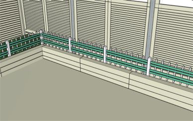

            Jeffrey, thanks for your consideration of my project. This is a really small fence, only 1.5' high. It is intended to add a little protection to a raised garden to keep out my beloved dogs who seem to like to dig and nibble plants. The garden is raised atop three stacked 6" railroad ties, making a total of 3' from ground level. The posts are custom made 2.5" square (actual). They are 2' tall and will be lag bolted to the topmost tie, 6" below garden soil. The horizontal elements are 3/4" x 1.5" x 4'. There are four horizontal elements to each bay, each supporting rather small 1" square 1.5' long pickets (7 to a bay, 5" apart).
            I am not planning to tenon, by which I mean I will leave the full size of the horizontal cross sections. To be honest mortising is an after thought... I was originally just going to toenail them--as it turns out I cut the boards long (on purpose) for a little breathing room but now decided I'd rather have the neater appearance of the mortise joint... that and I apparently want to buy more tools and give myself lots of work.
            I've attached a JPEG image of the fence. There is a larger fence behind it. I am not making that one! ;-)
            I'm new to all of this and so I do appreciate your feedback. Hopefully given the small scale of the fence, the materials will not suffer as you have warned. What do you think, now that you have the full picture?

                    Thanks for the JPEG it definately helps. Also thanks for describing the scale of the project.
                    The lag bolt below the surface is going to increase the structural rigidity of the project substantially. I would suggest putting the lag bolt in, placing the rails/runner in the post and then maybe putting a 3" screw in there to keep the post from moving. I would use Tightbond II in the mortise joints.
                    I think you can move forward with mortising the joints with either the mortiser or the router with a corner mortising chisel. I think they would be approxiamtely the same speed. If you go with the router make sure you build a jig to do this versus freehand (no way anyone can freehand 160 perfectly!). I have a few routers and the Delta mortiser. I would use the mortiser for this job.
                    Warpage is not as big of an issue seeing that you have all those little slat.
                    I would be my preference to go a little deeper on the mortise but if your material specs limit you to 3/4" you should be ok with gluing and posts that will not move.
