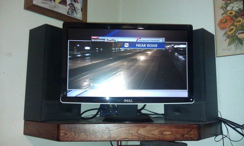

              Thanks for the info guys. (mpc, you lost my old brain somewhere around "the feds mandated ATSC") I didn't even think about the speaker problem.
              I just looked at the monitor in question again and it has an HDMI input. What I don't think it has are speakers, or any way to hook up an external set.
                Update. Changed the input setting on the monitor to HDMI, plugged it into the cable box and got a great picture. I had the monitor sitting on top of my scanner and had the old TV running for sound.
                The converter box has RCA jacks for connecting a TV with a component cable. I first tried to plug speakers directly to the audio jacks and got nothing. I callled tech support at my cable provider and he took me through several setting changes but none of them worked. I hooked the speakers back to the bookshelf stereo and was going to give up on the idea when it hit me. A TV has an amplifier to drive the speakers. RCA cables from the 'Audio Out' on the box to the 'Aux In' on the stereo and I got better sound than all but the high end TV's!
                A bit of rearranging and I have a system that looks and sounds good.

                The VCR is hooked up to the computer to convert VCR's to DVD's.
