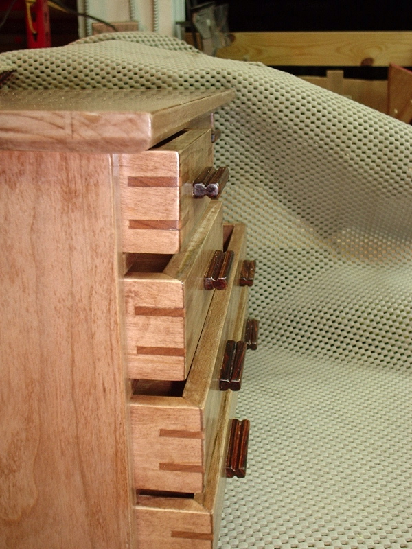

      This jewelry chest is made out of 3/8" cherry. The drawers have mitered fronts, reinforced with keys, and dadoes for the bottoms and backs. The joinery for the case is all done with dadoes cut on the BT. It's on my mind because I'm making a new one out of mahogony and walnut.
