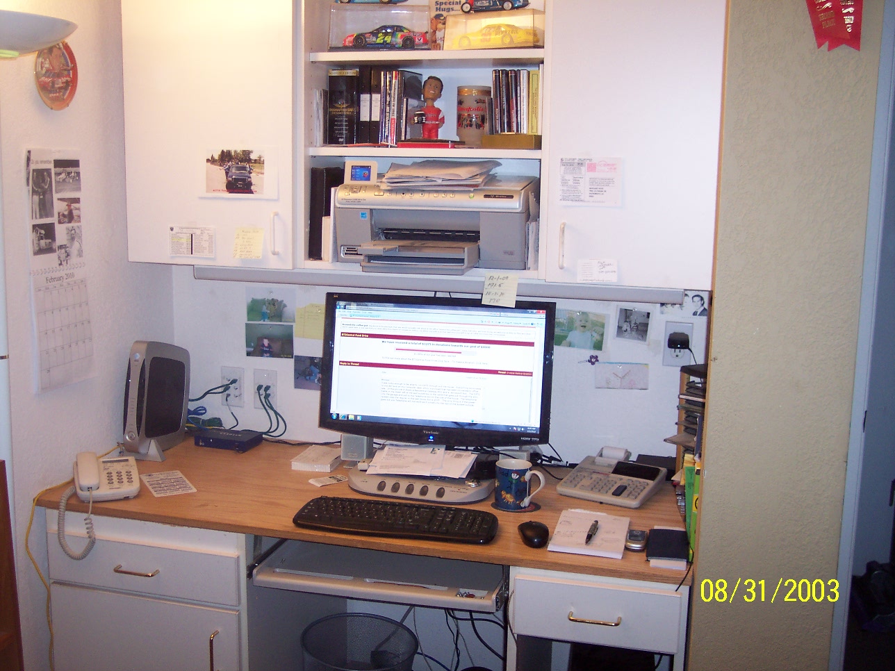

            It is like others have said. Depending where you COMCAST Cable is and where you phone enter the house, will determine how the install it.
            I was lucky enough to be able to run CAT5 through out the house. Everything terminates in my den and on my Computer desk which is a closet that has been converted to office use. In the picture it shows a Residential Gateway(RG) and an extra port box. The CAT5 Cable in the lower left of the wall outlet box is the cable that goes out through the attic, into the garage and out to the Telephone box on the side of the house. The telephone system uses the regular in the wall boxes but is VOIP. The only thing is if the power goes out you Telephone will not work as it is tied into the rest of the system outside. If you have Cell phone you are ok in an emergency. The system is set up for both wireless and wired network. The Yellow CAT5 by the phone is for my son's family when they visit as his work laptop is not allowed a wireless connection. All of the CAT5 runs for the TV's were run through the wall using the same wall box as the RG45 cable from Dish/COMCAST, so there was no cutting extra holes just new face plates with CAT5 and Cable jacks on the plate
            We love the system and have no problem other that a few power outages.
