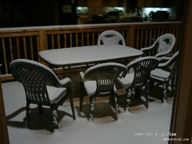

    See below for what out weekend weather looked like:
    Better you than me on that snow. It was pushing 80 here on Saturday. It is raining and cooler today.

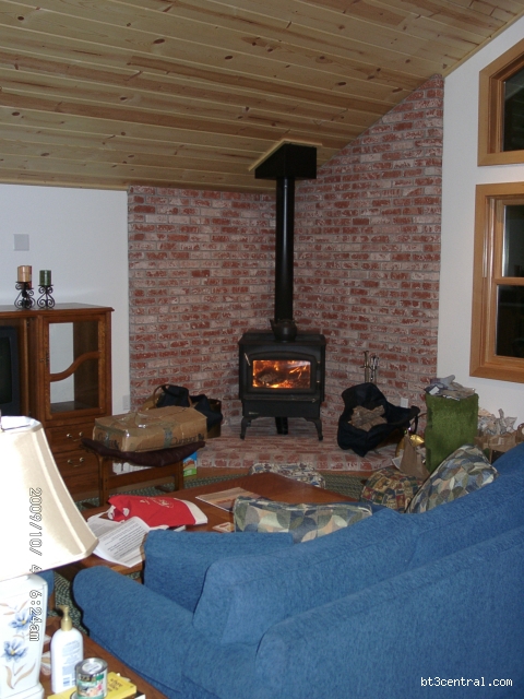

      Not necessarily. There wasn't much and I had this to keep the chill at bay :
