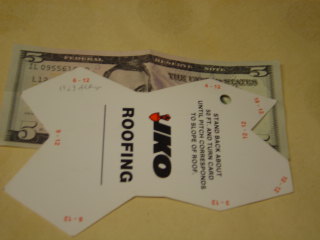

                Or you could go to the place you buy your shingles and the have a handy little cardboard card about 3x5 if i remember right with notches around the edge, just stand back and hold the card up and look at the peak of your roof and match one of the notches it will tell you the pitch!
                I used to have one out in the shop i will look for it and scan it if i can find it.
                Bud

                      That said, I used a spot that I knew was "level" for all practicle purposes, and was standing out in the yard (neighbors) trying to figure out what I thought was the pitch gauge (rafter layout section). That was when I noticed the degree section. I tried to match it up (hard to do on something not transparant) and when I was close for my guesstimate, when I made a stop someplace with an online computer, I typed in the angle and roof pitch and arrived at 6/12.
                      Yesterday, I finally found the paper at Lowes (cut out and match angles, not as nice as the one above), and started steeper and worked my way to a match (6/12).
                      My no measure estimate, and my measure estimate, would be about the same (a little higher on the no measure one).
                      It can be done, and thanks again.
