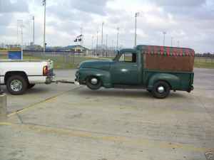

    I have seen a lot of trailers made from pick-up beds. In fact, I have one in the planning to match my '65 Chevy. This guy took things a step or 2 further!
    Found on the Austin Craigslist:
    Unfinished Home Made enclosed trailer, uses the front end, gutted cab, rear fenders and tailgate, really would be a neat business or motorcycle trailer. front wheels crank up for towing the tow bar is removable looks like and crappy old trunk when parked, have the windshield for it. AS IS bill of sale only. Need it gone $875.00.....Make Offer......Sell or Trade For ?

    A+ for imagination and creativity. A+ for recylling instead of sending it to the scrapyard (where it gets recycled anyway).
    But with gas prices where they are, I think I'd have something that's smaller and lighter.

      Looks like he spent a lot time and energy wasted, taking a good street rod project truck and turning it into a worthless piece of scrap iron! Some people don't seem to know the value of vintage street rod iron these days.

        I agree with Ezelock. What a waste. The old Panel truck are hard to come by. Bukt there is still enough there to make a good project if you have time and money. You could make a Retro Rod with the modern running gear and interior.

          Four or five years ago I would have tried to buy that truck and use late model
          running gear (front to back) and built a really nice street rod with that original straight sheet metal. I had a pickup of that same vintage years ago,
          and had a hard time trying to find good straight decent sheetmetal...it was almost impossible then.That is why I get upset when I see how mindless some people are, when they ruin something that is so hard to come by for someone else! eezlock
            I dunno, might still be salvageable as a street rod, he still has the windshield... I do agree there are much more efficient ways to make an enclosed trailer.

              In term of use as a trailer, doesn't the placement of the load-bearing axle put an awful lot of the load on the tongue? I don't haul with a trailer but isn't that an inventive but poor way of making a trailer? Which, all throws back to it would be a better rod. Interesting find, Pappy. We don't see much intact old iron up north.

                OK that thing is scary..
                Even with the engine/trans removed I'll bet it's pushing 3,000 lbs empty.
                It's a 1/2 ton chassis so it'll haul 1,500 lbs at best and the tongue weight will be huge.
                I doubt he setup any trailer brakes either. Plan to spend another $500 for a electric over hydro brake unit.
                I don't like the little 2x2 box steel beam he used for a tongue either..
                Still looks like a good body for $800.. Drop it on a late model chassis and add $10,000 in parts and paint
