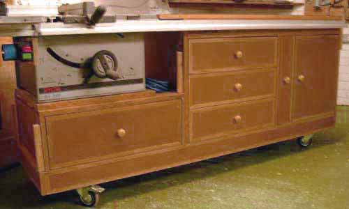

                      Sorry to hear of your incident - thanks for posting it, though, it reminds us all of the dangers to our hobby. Regarding moving the switch - I've done this (see picture below - click to enlarge):
                      It's the same switch, removed from the normal position, then re-positioned by mounting on an MDF bracket. There was enough cable, so no problems or need to re-wire anything. Have a look inside the carcass and you'll see what I mean. HTH
                      Ray
