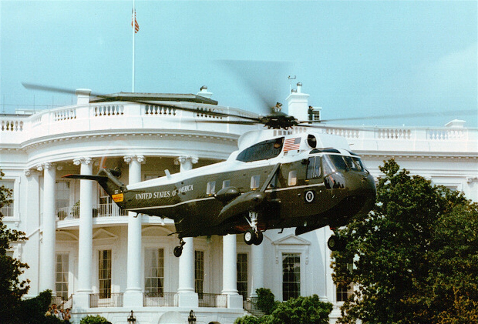

                  May I suggest a paint scheme?
                  The H-3 has done service as Marine One I know since 1970 when I was stationed at Quantico.

                      Pappy, that color scheme made it to the final two. In the end I couldn't decide between it and the last Sea King SAR bird flying out of Key West. I put it up to a vote and the SAR scheme won by better to 2-1! It will be white, gray and orange.
