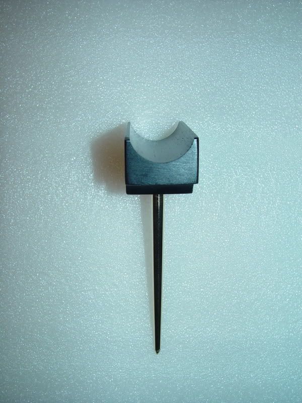

    Last night, after tennis, my 15 year opponent asked me if I could make a Cigar Tee. He wanted something that would hold his cigar while he is putting. He decided not to lay it on the ground when he saw the chemicals they use at our club.
    So...I made this today. A scrap of Gabon Ebony and a length of 1/4" brass rod. I turned the rod on my mini lathe. This was the first time I tried to turn metal. The tee is 5" tall.
    Steve
    Nice work. How did the brass turn? Did you have to get special gouges for it? Is the darkening on the brass a result of the turning or did you color it?

        David,
        The look of the brass is the fault of the camera. The brass came out smooth and brilliant. I used a progression of grits, to 800, while the rod was still on the lathe. Then I use Brasso until it was like a mirror. I have a Sorby mini lathe tool set. I used a tiny gouge, a mini skew, and, most successfully a mini scraper, with a hook. The groove, in the Ebony, was made with a round Viper router bit.
