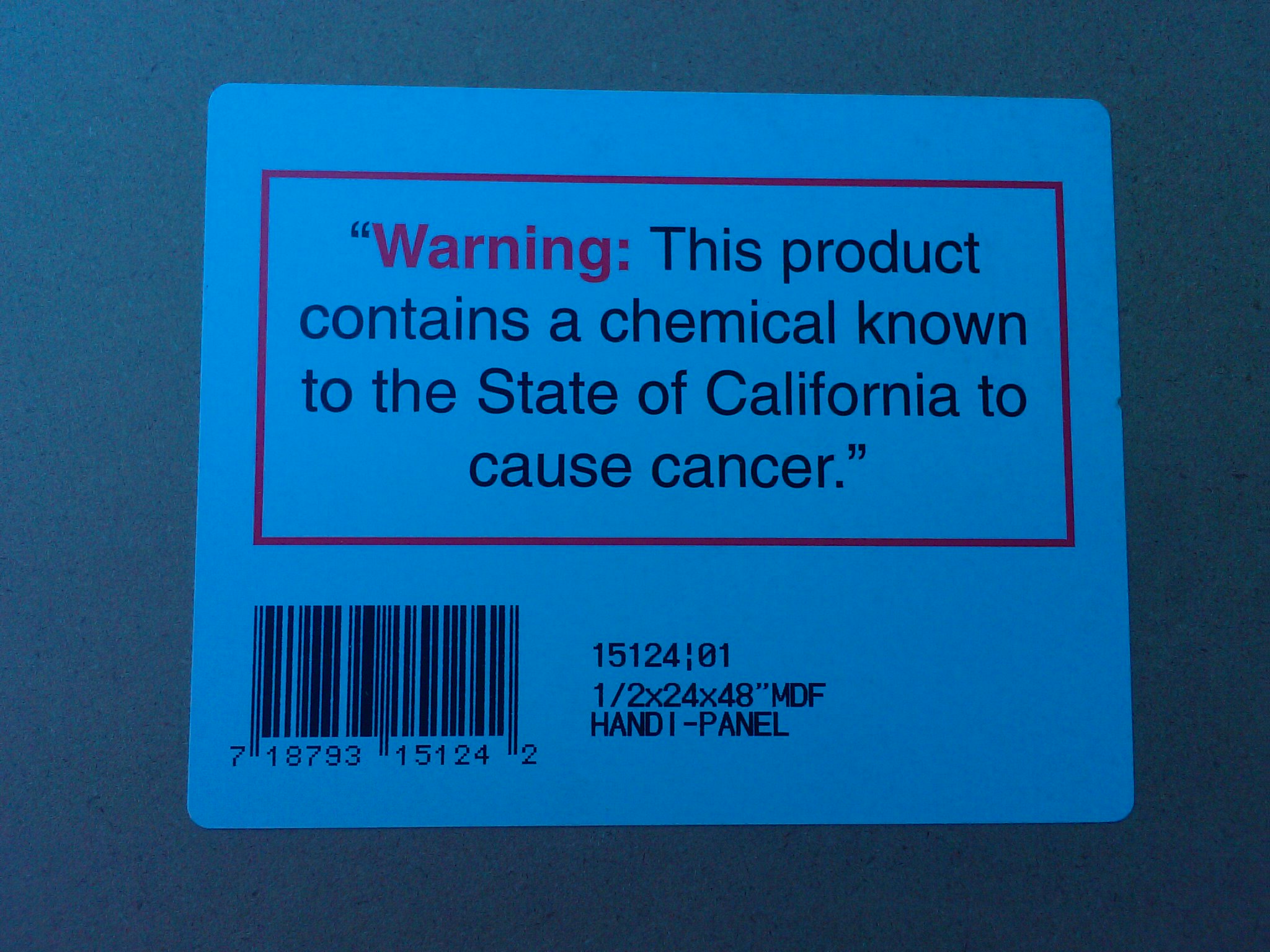

    I was at the local borg and noticed the 1/2" 2x4 panels of MDF had a warning saying this material has known chemicals that cause cancer. I've never seen this before. It was called Hardipanel MDF (if that makes a difference). But I didn't see the same warning on the full size 4x8 sheets. This new? What is the chemical they're talking about and how dangerous is it?
    They also don't cut MDF anymore. Not sure if this new as I've never asked them to cut MDF before.

    Anything and everything can cause cancer if you take it in large enough quantities. I've always taken that warning to mean that somebody somewhere took those full strength chemicals and exposed lab rats to a bazillion more times exposure than would occur in the real world until they got cancer. Then the chemical was labeled 'cancer causing'. I bought some of those panels at my BORG about a month ago and didn't see a warning. Must be new.

      You sure it was mdf? Hardipanel is a cement board product.

        No it was MDF. It was in the section with the other smaller sheets. 2x4 pegboard, 2x4 ply, etc.

          MDF contains urea-formaldehyde resins and creates a very fine dust when cut, making it much easier to inhale deep into the lungs. Urea-formaldehyde is a known carcinogen that the lungs can not eliminate. Add that to the irritation of the fine dust, and you take your chances.
          Use a mask.

              MDF and particle board contain urea formaldehyde, and plywoods contain phenol formaldehyde. I don't remember product data sheets attached to those products on a retail level. For the trades using those products, we get them all the time.

                      California's prop. 65 requires everything that could cause cancer to have that fact stated on the product. As a result, every store in the state has a sign by the front door, "This establishment sells products that the state of California has determined could cause cancer." Some places (Woodcraft, I believe) actually have it printed automatically on ALL their price tags! What a ridiculous law! I think it's had exactly the opposite effect intended; people tend to ignore warning labels now, because they see them all the time on everything.

                              Ah yes I forgot the note specifically stating something about "California Law" requiring the warning be placed on the product so these warnings may not be nationwide.
