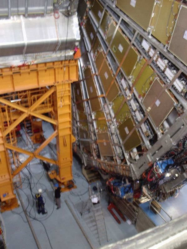

                  I have no idea what you're talking about, but it sure sounds like fun!
                  The pic is from the ATLAS detector at CERN, taken last Friday. They intend to collide protons and photons within a huge electro-magnetic array. The current going through each of the magnets is something like 20,000 amps.
                  The idea is that if you collide these atoms within the huge magnet, subatomic particles will be given off. These particles live a very short time, nanoseconds. During that time their presence will be deduced by changes in the magnetic field. The Higgs particle is a theoretical entity, smaller than a quark. That's what they're looking for.
                  Given that my BIL is trying to unearth the basic elements of all creation, I don't think I'll be posing any bowling-ball/ping pong-ball queries!
