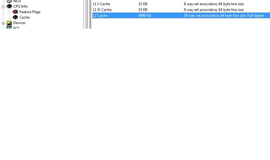

      I tried that program as well and I got
      -Paul

          I'm pretty sure the Q6600 has 8MB of L2. All the sites I've seen (including intel) confirm this. You may be thinking of the the E6600 (the dual core version) which has only 4MB.
          In any case I figured it out. The programs I was using to determine what hardware was installed were the problem. It's actually 2 sets of 4MB. I used another program called cpuZ (grreat program btw) and it showed 4096kb x 2. I then confirmed this with the BIOS (which is what I should have done in the first place but didn't think of it). Thanks for the advice guys.

              It's only seeing one processor pair -- that processor has 8MB shared, or 4MB per core pair.
