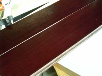

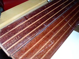

        If fairly smooth but there is a slow spot along the side of one wall. Here's a pic of the wood floor. I decided to get it and if I can't use it I figure I can give it to my brother. Besides it only costs $50. Do will I need to put a layer of plywood under it as a sub floor. Or can I float it over the concrete? First pic is the bottom part of floor 2nd is top.
        -Paul
          Depends on how low the low spot is. Mfgr will spec the tolerance and whether you can float over concrete. From the pic it looks like the edges are quick-lock and not nail down? I've not seen a tolerance more than 1/8" for low/high spots. If that is the only problem area you can get a self-leveling compound in there and feather it out to fill the low spots. What I posted earlier is more a resurfacer for fixing an entire floor. Something that I know will work is to put in a ply subfloor on treated firring strips. Then you can always nail your flooring to that or float over it. Don't forget a vapor barrier test. Take a few square feet of plastic and tape it to the concrete. Leave for 24hrs or so and take it up. If it is damp under the plastic you need a vapor barrier. The mfgr will have that info too as to what you need.

                Looks like a laminated wood over an MDF core. Most of that type can be floated over concrete.
