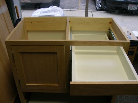

    I am having a bathroom done. The contractor has 30+ years in doing this type of work. I got his name from a old-time union carpenter that has helped me on projects and who I trusted. I'm paying about $15,000 for the work. Not as much as some people put into bathrooms, but it is a pretty simple job. I'm not moving walls and I went with a pretty inexpensive tub/toilet, etc.
    The contractor mis-ordered the vanity. Here are the problems:
    (1) Vanity is 21" deep instead of 18"
    (2) There is a divider from front to back that is centered in the vanity. On the left side is a cabinet door. On the right side there are three drawers. The divider supports the drawer slides on one side. Due to the positioning of this divider, the sink bowl and drain will run right into it.
    (3) The cold-water pipe comes into the cabinet on the right-hand side of divider (behind the drawers).
    The contractor proposed doing the following:
    (1) Return cabinet to custom shop that made it. They will take it apart and cut depth down to 18" and reduce depth of drawers.
    (2) The installer will "scoop" out part of the divider for the sink bowl, and then cut a section of the divider out to accomodate the drain pipe.
    (3) The cold water pipe will be left angled behind the drawers and run into the cabinet part (behind the door), then have a shut-off attached.
    I know that I'm not explaining this great. But there is a lot wrong with the vanity. The contractor doesn't want to eat the cost of the vanity. I'm insisting that there are just too many compromises. We're both pretty PO'd at each other right now.
    I asked him if he has ever, in his thirty years, had to remove material to install a drain before and he said no. I don't know why I'd let him start now.
    I think I'm on solid ground insisting on a new vanity. I mean, this is only the stuff he is admitting to having to do to make it work. I know he'd have to make one of the drawers quite a bit more shallow than the others to accomodate the cold water pipe running behind it.
    And what if I have to have the trap cleaned out. I don't want to find out later on that the top of the vanity has to come off to get at the drain.
    Argh!!!
    Here is a pic of the stupid vanity.

            From what you said, sounds like there wasn't planning on the majority of the job. I would first like to address your attitude towards him. If you use the lawyer thing, most likely it will get to a push and shove. If he resists the threats and continues with his course, it could take you a long time to resolve the issues.
            If there is a way to nicely handle the problems, it would benefit you in the long run.
            So, for an immediate fix, the problems aren't your fault. If he used a "custom" shop, they should have come to your house and taken their own measurements and noted the conditions which would affect their work. From looking at the picture, it doesn't seem possible that happened.
            In resolving the problem with the cabinet, to modify the drawers by taking them apart and changing the size will not be prudent to install the cabinet as a "made to fit". There are times that some cutting and trimming is necessary, but this case is a clear indication that proper measurements were not taken.
            The usual procedure for this type of remodel is that the GC has his cabinet guy do the measurements, then the cabinet guy does his drawings and includes all the details, colors, finishes, hardware types, drawer construction, and anything else involved with the work, and submits them for approval. The GC should get you to sign off on them.
            Those drawings become part of your "contract documents". They exist as the main plan for what is needed and approved.
            For whatever reason the cabinet is wrong, ask the GC how that happened. If the repairs are too extensive or you feel the modifications will yield a less than satisfactory product, don't settle for that. That isn't what you're paying for.

              Thanks Cabinetman. I think I will call the cabinet shop tomorrow and have them send someone out to take some measurements.

                          I worked in custom cabinets for quite a while. Long enough to know that these weren't custom cabinets. Cabinetman is right. If it's a custom cabinet job of any size, the cabinet man will be there to measure and then later design for approval. The cabinet he is trying to use may indeed be one from a custom cab shop, but it's apparent that he either got a deal on it or he has already eatten this because it was built wrong for another job and is passing on the shafting to you.
                          There are many ways to design cabinets and allow for special piping and electrical limitations. You are basically getting charged custom prices for apparently a now off the shelf cabinet that will need to be modified.
                          Personally, I might do the same thing myself in my home were I to find a great deal on an existing unit. You can bet your sweet potatoes that great deal would not be custom cabinet build and installation costs.
                          Ask him which cabinet shop built this.
                          Bottom line is this cabinet is not suited for the job and will need to be severely altered to fit the application. It is the responsibility of the contractor to see that these are designed right and he obviously failed. It should be his dime that produces a completed functional unit in the space as initially agreed on.

                              There's the whole problem. Unfortunatly the contractor will have to eat the cost of the cabinet. He is trying to aleviate the problem with the compromise but remember, he's leaving soon and you will be living with it a long time.
                              I suggest that before you start thinking of lawyers and reporting him that you sit down with him or write a letter, calmly explaining your posistion, i.e. custom work, and let him know that you really wish to resolve the problem. Hopefully that will help. ( I wouldn't give any thing back but he is going to ask for something)
                              You may get threatened with a mechcanics lien. IANAL but I don't think he can just slap a lien on you if your contract states that you are not responsible for measuring or ordering the cabinets.
