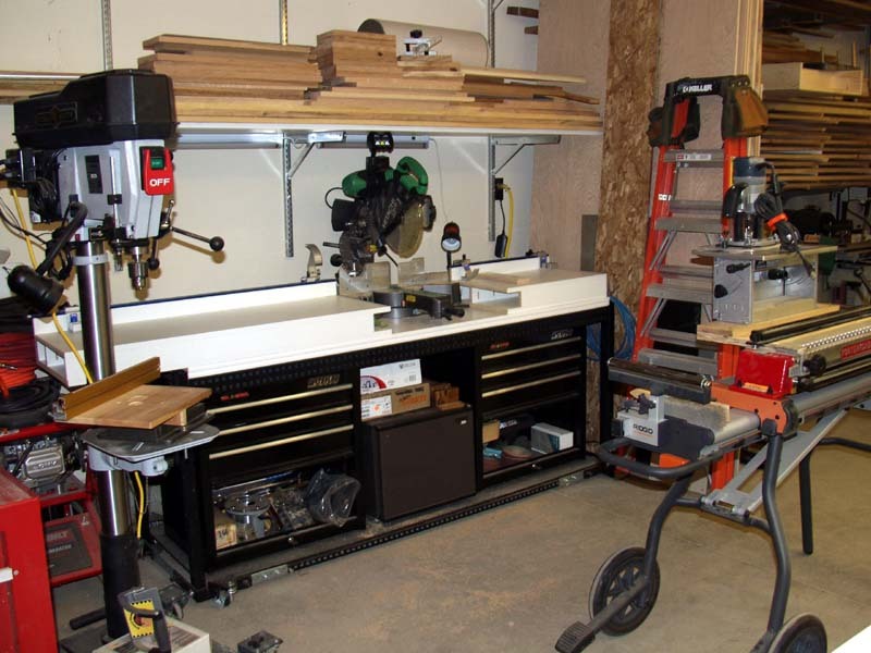

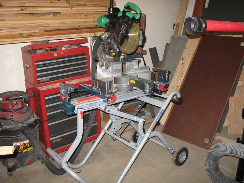

The saw is heavy. I had it on a Bosch T4B gravity rise stand. The mounting hole placement in the saw base made that mounting kid of goofy. It would not line up its fence with the extensions of the base. I would recommend that saw be used on a different stand (maybe a Ridgid MSUV) or be mounted on a sub table and then mounted on the T4B stand. Ideally I like it in the shop on a miter saw table setup.
