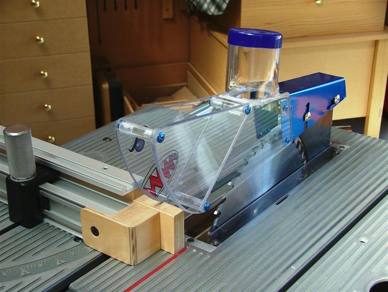

            Shortly after I "joined the club" (about a month after I got the BT3000), it prompted me to make my own "ends"
            You can see the red line (LOML's nail polish) - AND the Shark guard.
