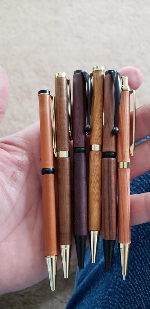

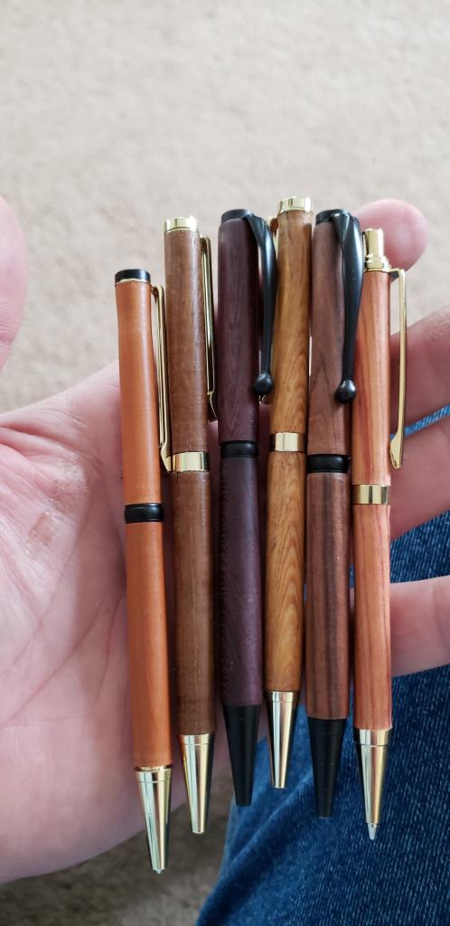

                I may have a habit . Click image for larger version
