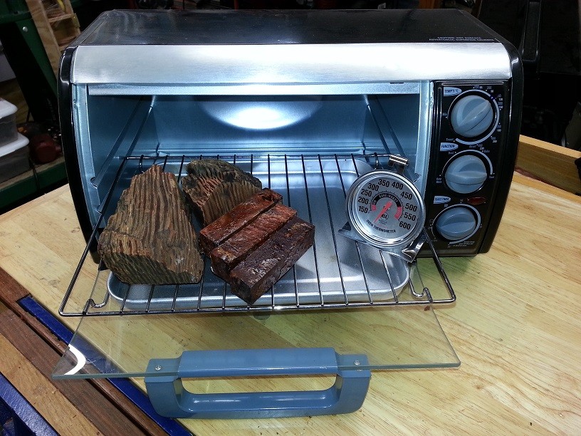

    I tried out the asparagus steamer pot vacuum chamber with some wood blanks and the Cactus Juice, it worked well. Final cure happens via toaster oven. Attached is a video on the process I used. Thanks for watching.

    Is that a regular toaster oven? I'll have to check that out.
