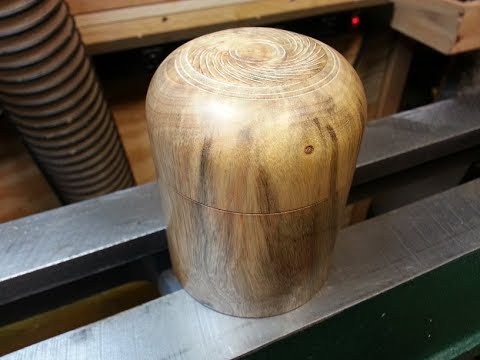

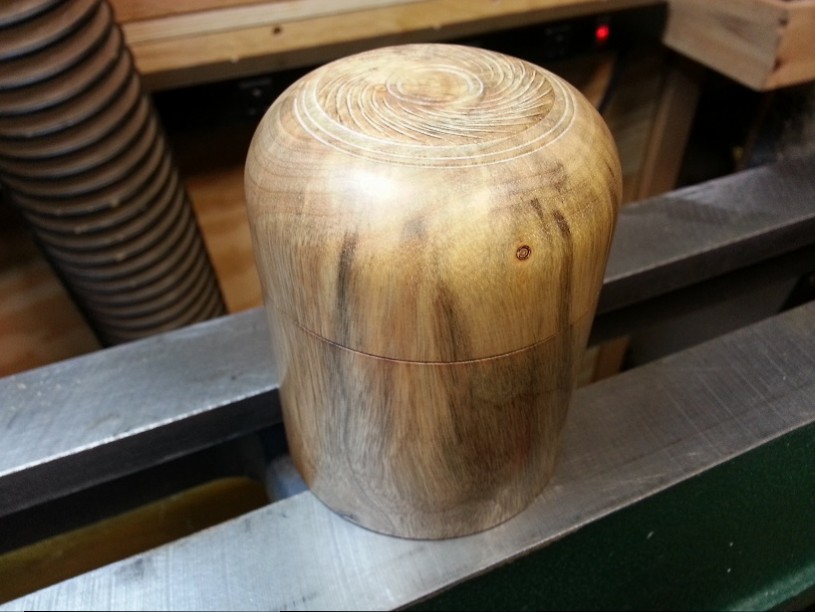

    Still have lots of camphor, I'll try to use something different in my next project In this video (link at bottom), I turn a lidded box and use a Sorby Micro-Spiralizer tool to add some decoration. Thanks for watching!

    I really like the spiral. Looks Great!
    Do you sell any of your turnings?
      • 1865
      Thanks Hank. I mainly donate to charity auctions, and haven't dipped a toe into direct selling yet, but considering starting an Etsy page... of course, Etsy may already be inundated with similar offerings.

        Bill - I have watched your video a few timies now and just noticed that
        you used the parting tool "upside down" - or does it matter ??
        it just looks like it would grab in the inverted position. Just curious.
        excellent work !!!!!!!!!!!!!!!
          • 1865
          Thanks Johnny. I'm guessing you're talking about the thin parting tool, since I don't believe the standard parting tool (also used) has an "upside down". I learned how to use this tool in either orientation, and my use changes back and forth depending on the cut and how the wood feels. In the position shown in the video, the tool is behaving more like a thin-kerf negative-rake scraper during the parting, and negative-rake scrapers tend to be less "catchy" for me.

              Johnny, I believe Sam Angelo is a well regarded turner, I found one of his videos also demonstrating various parting tools, including the thin kerf, similar orientation to my "upside down" use: https://www.youtube.com/watch?v=d-qugZiMQyM
              Check out 10:40 and 12:18
