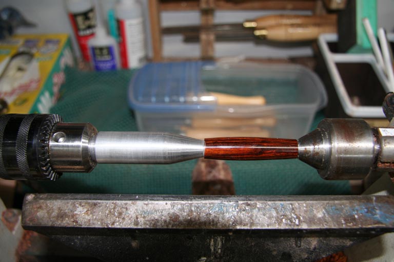

    I decided to give it a try. It requires a "dead drive on the head stock end. I do not have one but I had an aluminum rod 20mm in diameter and about 10 CM (4 inches) long, so I made a "dead center drive for pen finishing. I don't use it for getting the blank into the general shape but for finishing. I have done 4 pens with ebony wood and no problems so far.

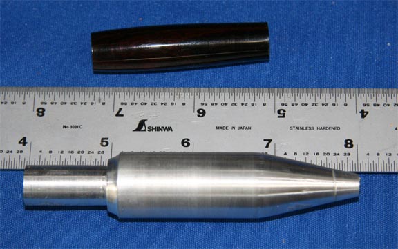

    Picts:
    On this pict, you can see on the left end of the blank how the CA often separates from the blank when removed from a bushing. If you double click on the pict it will enlarge and then the separation can be seen at the point that the reflection meets the left end of the tube.
    My dead center, that I use in a 2MT chuck drive:
    For people in the USA, you can order a "dead drive" for $5 - $10 plus postage from several places.

    So why do you want to use a non-live tailstock for the pen? If you're running the lathe up, wouldn't the friction on the tailstock cause at the very least discoloration of the pen body? Or am I just totally missing something here?

      I believe he means using the dead drive in the headstock end, with a live center on the tailstock.
        OTOH, I've not turned anything since high school, so I could be way off base here. It's been known to happen.
        g.
        you've got it. He's using a dead drive in a drill chuck on the headstock and a live center on the tailstock.
        As he mentioned. PSI and others sell #2mt dead drives that would eliminate the drill chuck.

              Here are two places to get the dead center, which by the way is sometimes called "Revolving Centers" but when they have those names, the price is 3 to 5 times as much!
              http://www.grizzly.com/products/h7967
              http://littlemachineshop.com/product...ProductID=1890
              You are right, I take it off the mandrel after turning and see how close the fit is in some cases (where it is easy to take apart), then move it to the dead drive. I may do some extra sanding from the dead drive but not turning.
              I believe that an experienced turner could turn from there, but it will take skill, patience and experience.
              To me, it is MUCH easier finishing that way. Bushings get into my way when I am finishing a pen.
