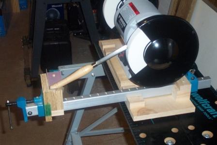

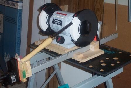

      Here is a pic of one I ran across. I have not made one yet but I like the use of the bar clamp to give it adjustability.
      Scott

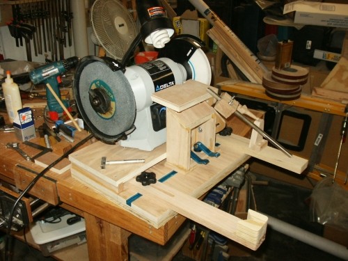

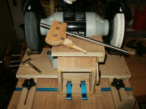

        Funny you should ask. I just spent a good portion of this weekend making one. I got tired of not being able to hand grind a good edge. I've only had time to try it on a couple of bowl gouges, but OMG what a difference. It really makes an amazing difference to have a very sharp tool in your hand. This was time very well spent. I followed these instructions, somewhat.
        http://www.turningtools.co.uk/widget.../wtsharpen.pdf
        Here's a couple of pics of mine:

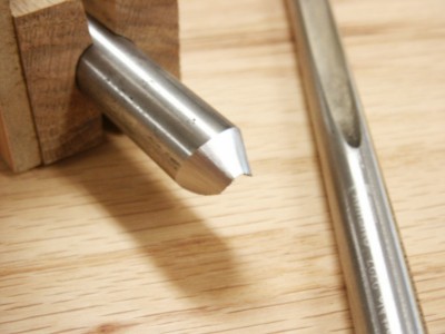

        Here's the first try on a gouge:

          Scotty, wish I would have seen your post a few days ago. That's a great idea using those aluminum clamps. I have a bunch of the HF ones, and I would have used them had I had your smarts.
          BobL.

                Which direction does the wheel spin on a grinder? If I'm looking at the front, does the top spin towards me or away from me?
                I really am going to make something one of these days.
                • boblon
                  • 727
                  • Florida, USA.
                  The wheel of the grinder comes toward you from the top, down past the item your grinding.
                  In fact, in the pictures above you can see the arrows above each wheel indicating the direction of travel.
                  BobL.
