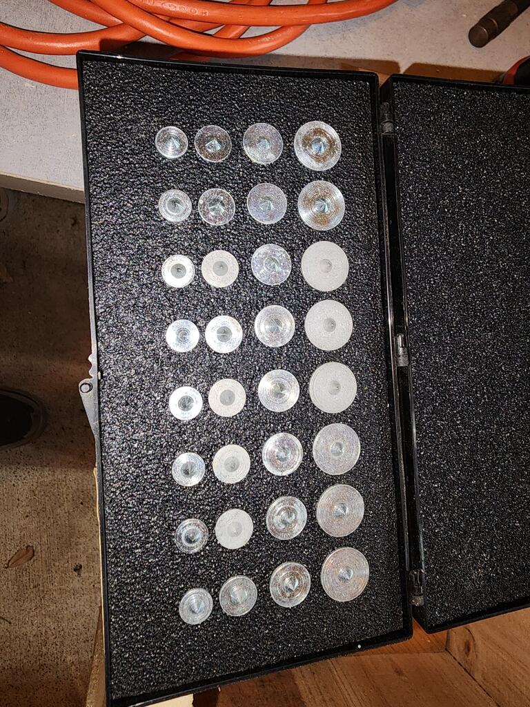

    Anyone use dowel centers?
    They're inexpensive and a great way to line up dowels for assemblies where dowel jigs don't necessarily work.
    I have sets of four sizes 1/4". 5/16". 3/8" and 1/2"
    Pretty much I have only used the 1/4" and only ever needed four, so I went overboard
    A set of four 1/4" ones is a really cheap woodworking accessory.
    Click image for larger version  Name:	20240429_214705.jpg Views:	0 Size:	239.4 KB ID:	858706
    Click image for larger version  Name:	20240429_214615.jpg Views:	0 Size:	109.3 KB ID:	858707

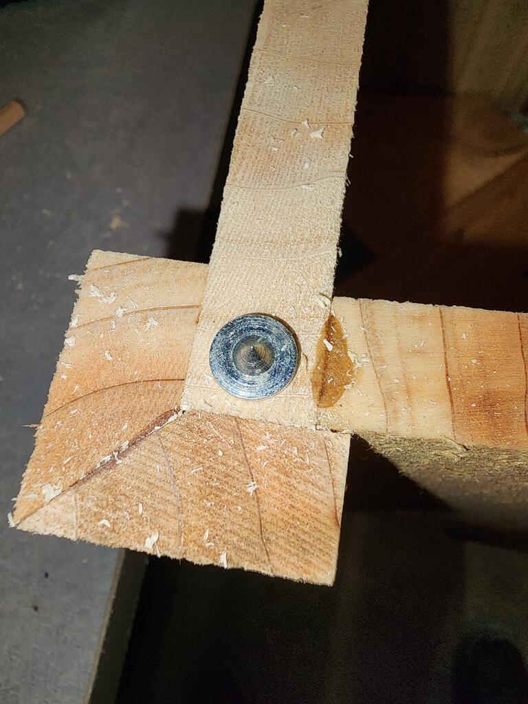

          Today, I'll be fitting the fronts to two drawers on the stand by using dowel centers to mark the box front side. I don't use the false front method of drawer making by adding a front to a finished box. Waste of space and material in my view.
          The dowel centers will be fitted to holes that were drilled with my self centering 90° dowel jig, and the fronts centered in the opening and marked with the dowel centers. worked on the upper drawers!
