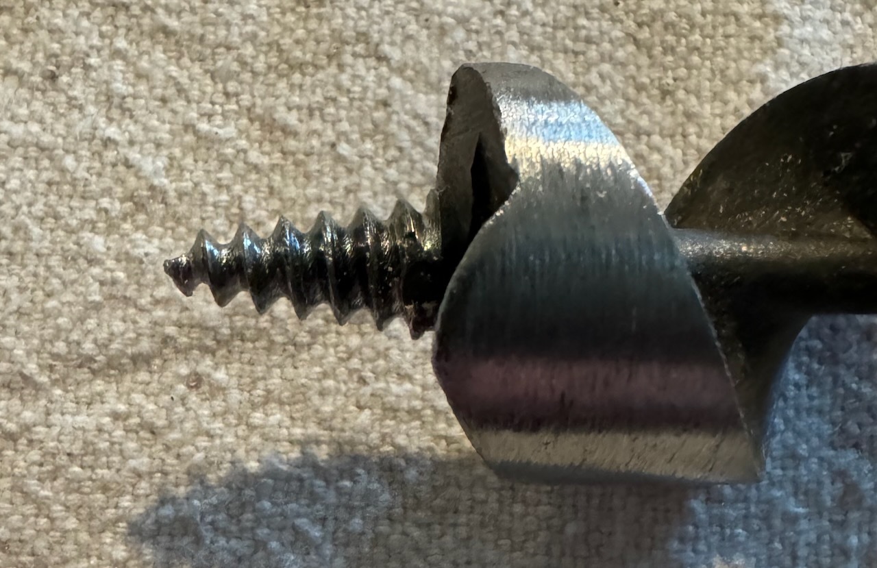

    There are only two parts of the auger bit that matter when it comes to being sharp and both are easily cleaned up with a file. The bit shown below is in desperate need of sharpening.
    The first is the main cutting edge. This cleans out the center of the hole. A few minutes with a file will clean this up and make a world of difference. Since this does 90% of the cutting you could just do this and be good to go.

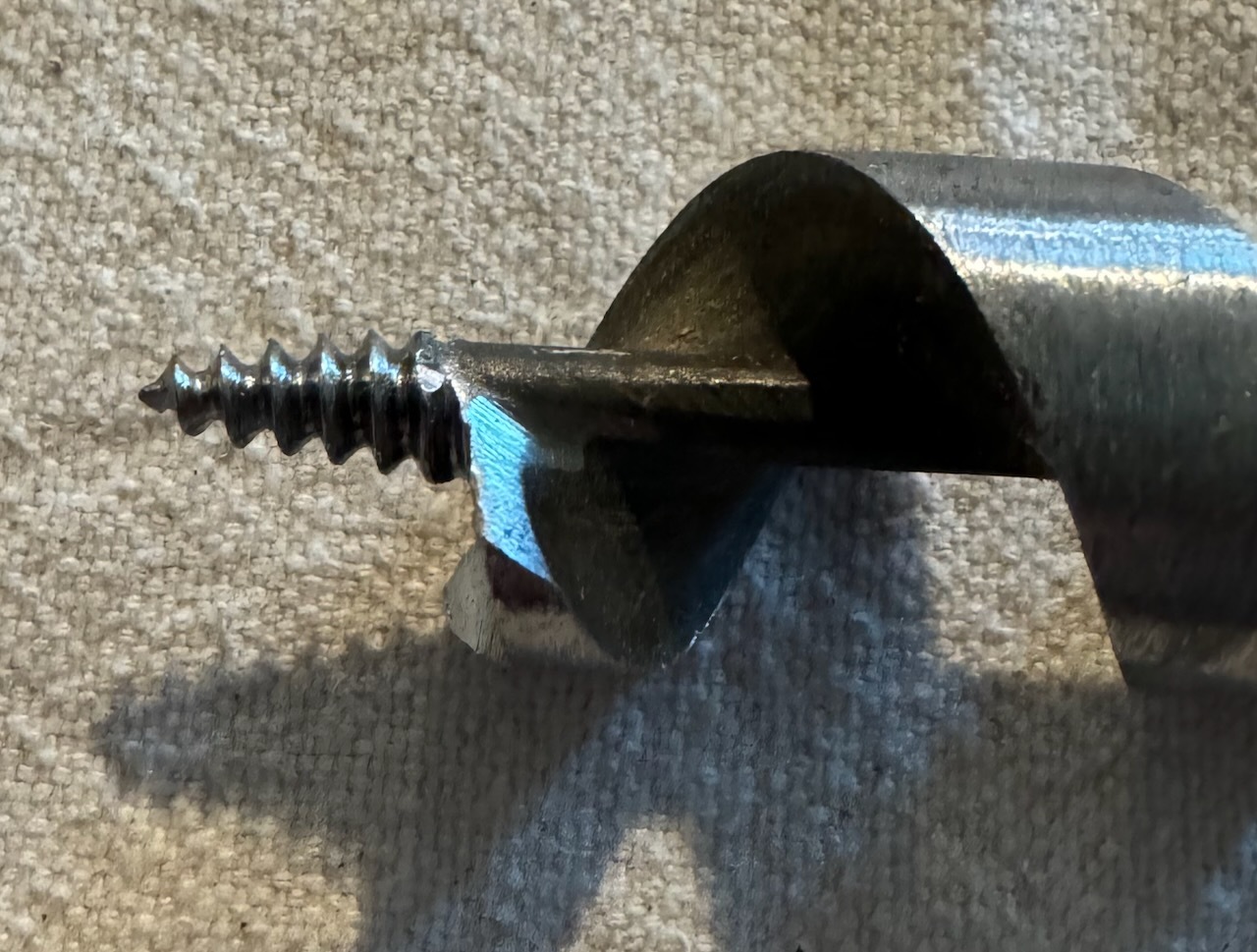

    Opposite the cutting edge is the spur. Some are pointed and this one is round. File the leading edge from the inside of the bit so the outside stays the same size and shape. This is what cuts the egge of the hole and gives a nice smooth wall.

        Sandpaper on a dowel or bolt may work since you are drilling into a stump and not doing fine woodworking. A Dremel sharpening stone ma work as will if it is the right size. A chainsaw file would probably be about the right size. Looks like you are spending some money one way or the other.
        I use auger bits mostly for drilling through studs for wire and know that I need to sharpen it if the screw strips because the bit isn't following it or if my drill tries to break my wrist.
        Just for my own amusement, I drilled two holes in a piece of 3/4 birch.
        The hole on the left was before sharpening and took ten rotations with a brace until the screw popped out the other side.
        I then spent two minutes with a file on. the bit I posted earlier.
        The hole on the right was after sharpening and five and a half rotations and the hole is quite a bit cleaner.
        Conclusion: A sharp auger bit will cut nearly twice as fast.
