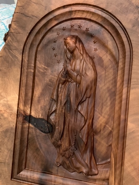

It's very impressive. Above you said the cutting size was 48x32. How did you get to 80" for this piece? BTW, I can't find the difference in height you mentioned.

There was some sanding but not as much as I anticipated. Most of it was actually sanding the flat spots outside the carving. Honestly I was surprised at how smooth it came off the machine. But then again I was doing a 4% passover using a 1/16" tapered ball nose bit. When I paused the machine for the night (didn't think my neighbors would appreciate a router running all night) and start again the next morning the depth would drop between 1/64 to 1/32 so it developed a small ledge which I had to sand and blend the 2 surfaces together. You can still see a bit of it because I didn't realize I didn't sand enough till I put on the finish.
It's around 18" wide by 80" tall and just under 2" thickLeave a comment:
