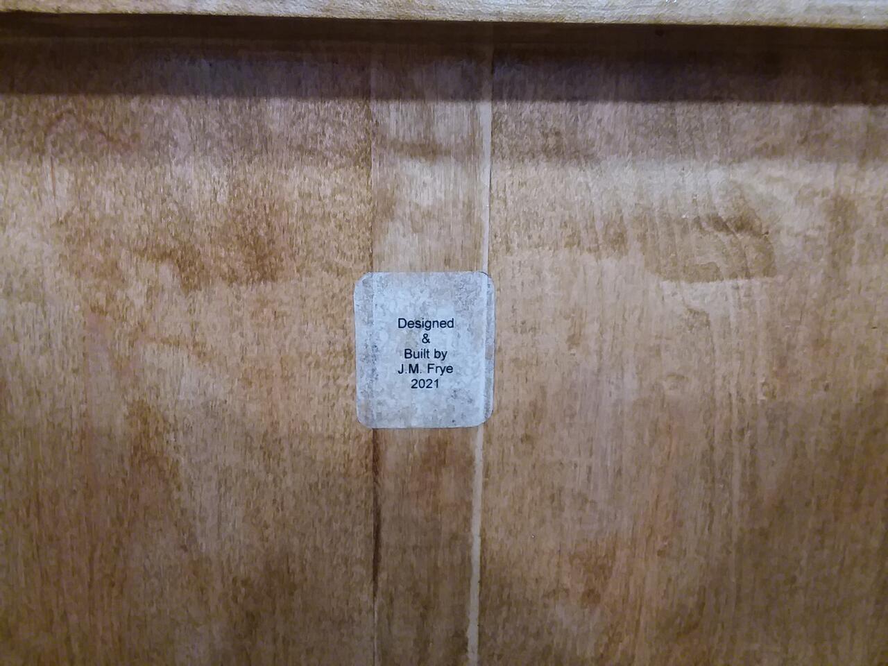

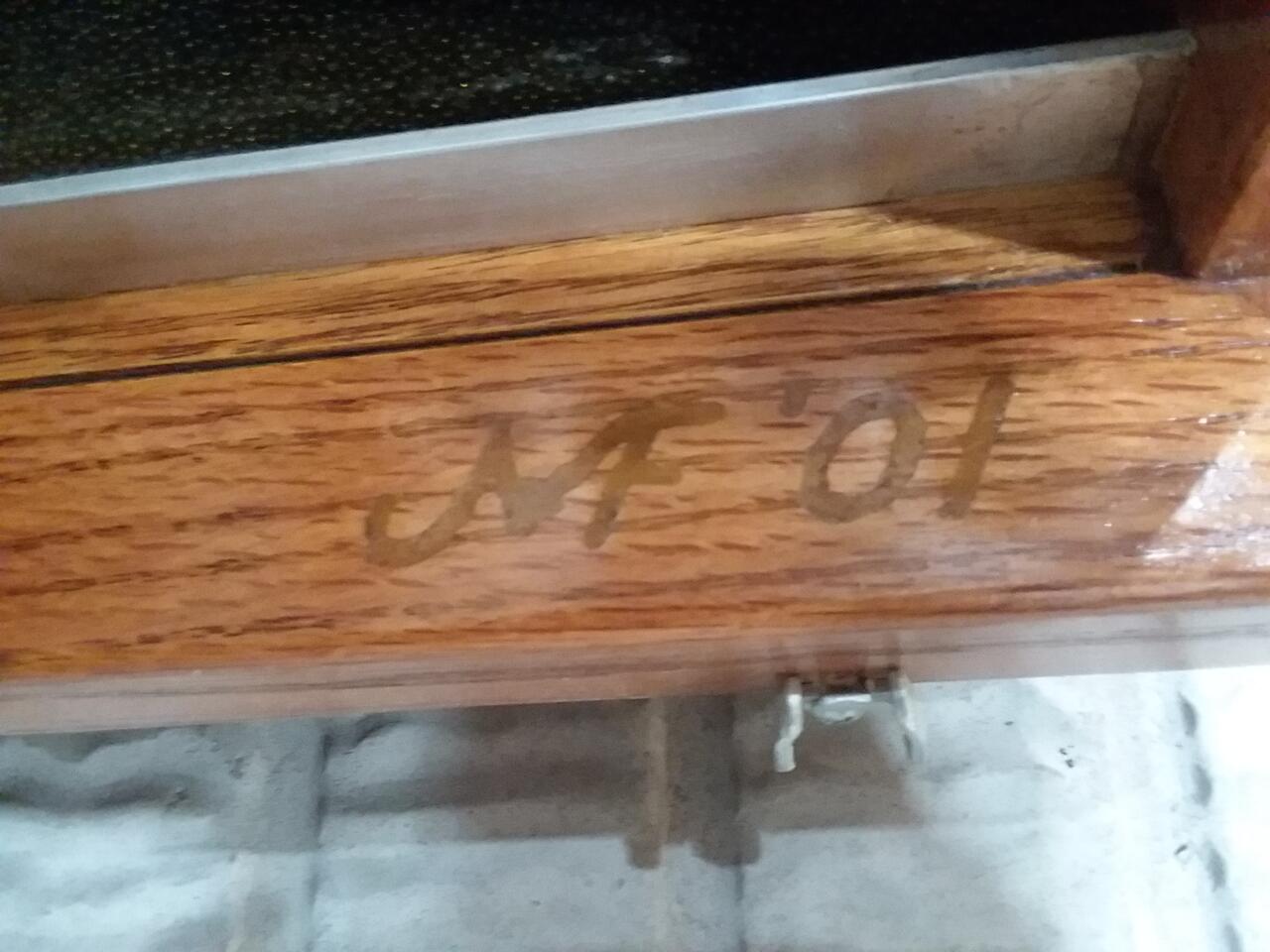

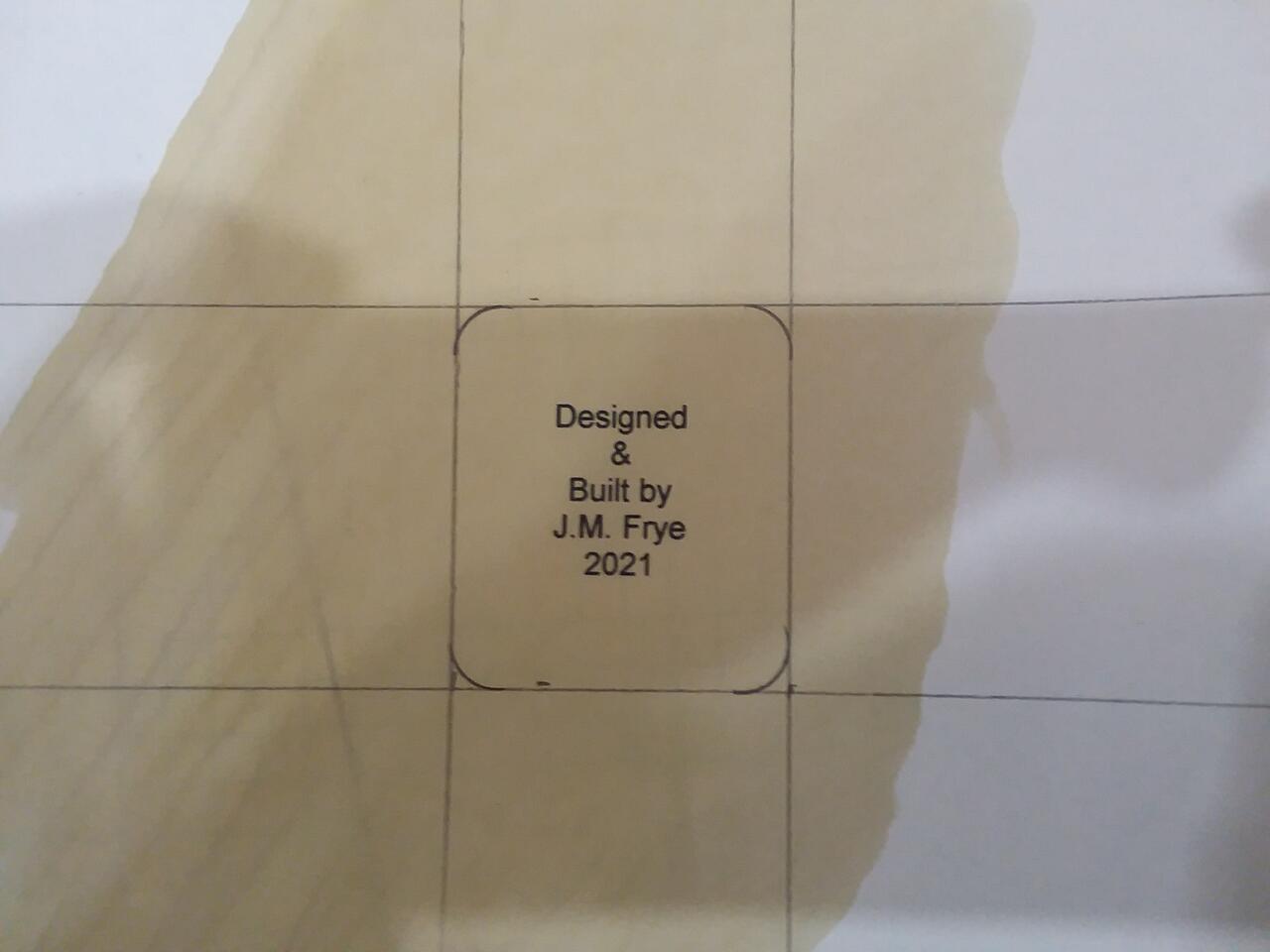

    Up until about ten years ago, would carve my initials & the year of the build into the back or bottom with a 1/8" ball burr in a Dremel. Then I would fill the carving with wood filler, sand flush and then it got finished with the rest of the piece. Now I print a small label on the PC. I then coat the label on both sides with wiping varnish to seal the ink and plastize the label. This makes the label translucent. To make it opaque, spray the back of the label with white paint. Once cut to size, I glue the label to the inside, back, or bottom of the piece. Then it gets finished over with the rest of the piece. The finished label has an antique look to it from the varnish.

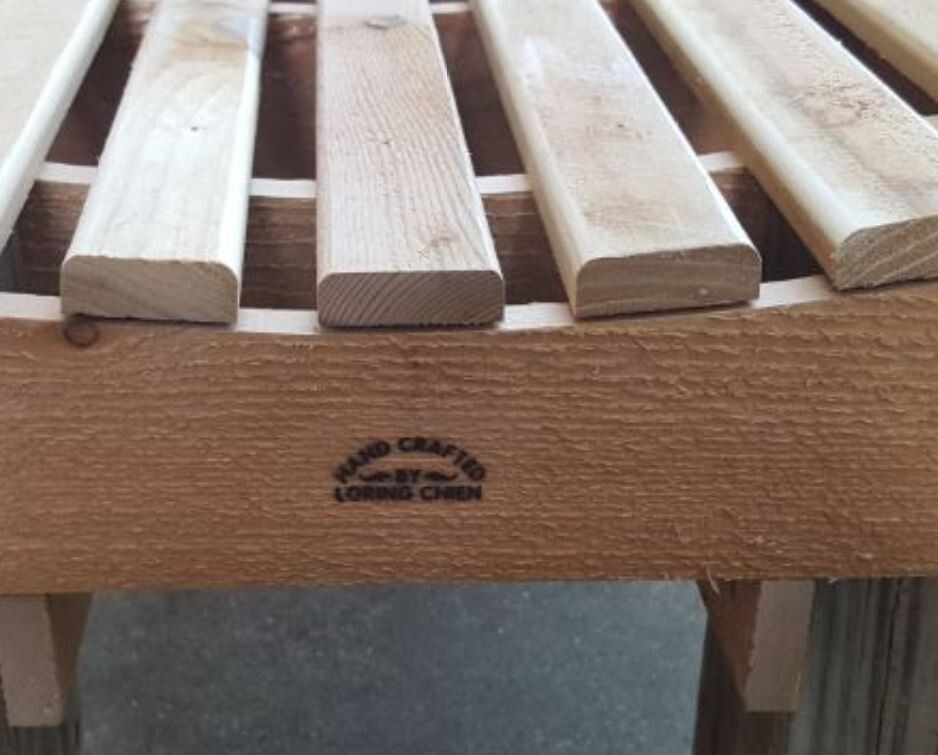

      In the past on my larger items such as book cases, tables, hutches, I would write my name, date and location with a carpenters pencil on the bottom of a table, bottom and top of book cases and hutches. But NOW, I have a branding iron. My daughter asked me to bring it and stamp/brand the things I have made for her. I also added where the board/lumber came from (whose house/office) in special situations. That makes for special memories.
        I have posted about my iron a few times. I think this was the most recent/comprehensive discussion.
