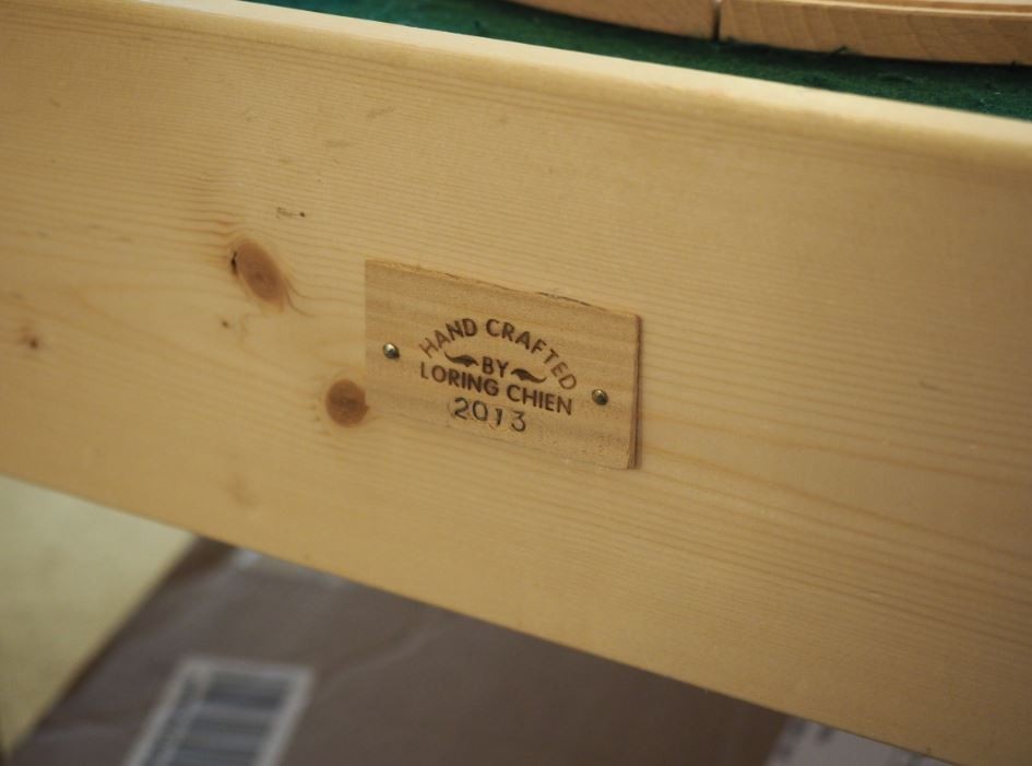

    • Sometimes its safer and more time efficient to make small thin plates en masse and then affix them to the piece with brass nails or screws.That way if you screw up you don't lose so much

      I like the last one that is attached with brass nails.
        Yes, the plate method saves time and eliminates lots of risks of screwing up which are many as I pointed out.
        Downsides are the wood might not match and it looks a little less like part of the original, a bit of an afterthought.

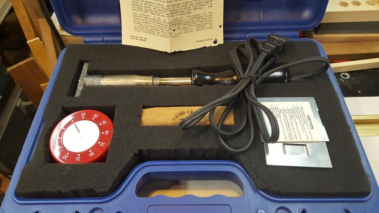

          And this is my pawn shop storage case. Got a cheap eBay dedicated timer so I don't have to hunt one up each time.
          Click image for larger version  Name:	20200804_001219_resized (1).jpg Views:	0 Size:	151.5 KB ID:	840140

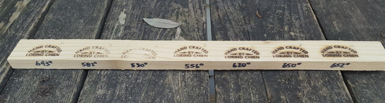

              FWIW, I wanted to get a better handle on the temperatures it took to get a quality burned impression.
              The image below was a series I took with the temperature marked (using an IR thermometer that went to 752 °F)
              The leftmost impression was after the iron was on for the recommended 15 minutes. The second and third was as it cooled down - it rapidly went to unusable.
              I plugged it back in and took some impressions as it heated up again (the last four.as it heated to over 652 °.
              Each impression was for 15 seconds with a slight rocking as recommended by the instructions.
              Clearly the result is you need more than 600 °F and 650 °F starts to char all around (but as the instructions say you can sand it lightly to remove the background charring. The one on the right will, in my experience, clean up nicely with a light sanding to remove the slight overburn.
              Click image for larger version  Name:	20200829_181644_resized.jpg Views:	0 Size:	97.8 KB ID:	840452

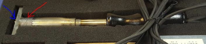

              One more thing I found odd was that I measured all these temperatures were measured on the barrel right behind the branding plate
              where I assumed the heater was and that the plate would be the same temperature. What I found was that the face of the branding
              plate was much cooler as shown by the blue line. The letters are the time and temperature points where the test impressions

              Found on the internet "The initial process of wood burning is at 160-260 degrees Celsius (320-500 degrees Fahrenheit). Irreversible changes begin to appear in the wood, ending with fire. The ignition temperature of the wood varies between 200-250 degrees Celsius (392-482 degrees Fahrenheit).Mar 15, 2020"
              So its likely the blue temperatures were really making the burned impressions; yet I am surprised by the difference in temperature (BTW it was 96 °F degrees in the shop that evening - why it starts at nearly 100 °F.) The temperatures read off the heater barrel (red line) were more stable to read.
              The picture of the iron above has a red and blue arrow showing where the temperatures were measured.
