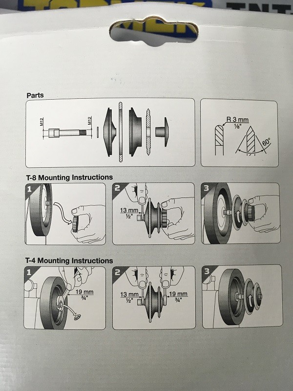

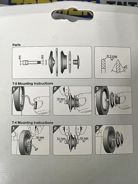

                  I finally opened mine about2 weeks ago. Another one that sat in the box like Lee's for over 2 years. Now a new question.
                  I was in Woodcraft a couple of days ago to pick up some honing paste since the tube with mine was fried up. While there I was looking at the Tormek LA-120 Profiled Leather Honing Wheels.to enhance the leather strops. Anyone tried to mount one to the Grizzly 10" grinder? Did it fit out of the box or was there some modification to either the kit or the grinder needed?

                      Looks like no one has tried to fit the Tormek profile wheels to a Grizzly grinder. I'll check the threads on the Grizzly mounting shaft. If they are M12 threads I'll give it a try and report back with the results.
                      EDIT: According to the picture of the package I posted the Tormek mount shaft is an M12 thread. I took the retainer knob off the honing wheel of the Grizzly to Lowes with me yesterday and it matches to an M8 thread so it looks like a no go short of finding a way to adapt the threads. It was worth a shot!
