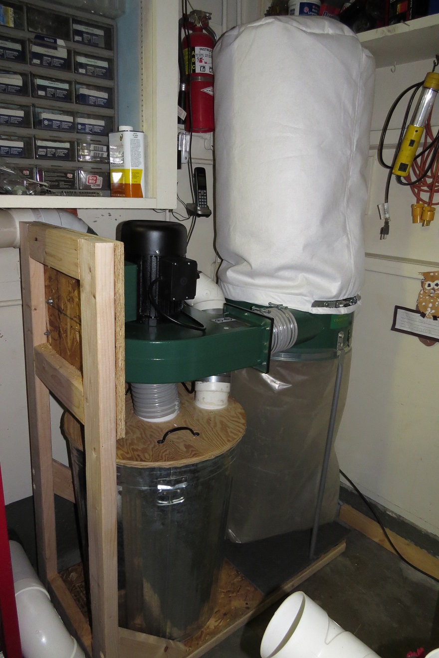

            Thanks for the thoughts guys. Picked up the HF DC today and hope to find some time to assemble in the coming week.
            The picture in Ruben's response to Dave's DC thread - the 6in intake on the impeller, piped straight to the exhaust on the Thien baffle - is the setup I was thinking about.
            Originally posted by Ruben
            I dont understand exactly why you want to get rid of the separator? if it's just floor space, there is a lot of designs for HF dust colector adding the separator and keeping the same footprint like this one. (picture from lumberjocks)
            PS: after reading your first post again, now i understand what you mean.
            [ATTACH]19329[/ATTACH]
            I'll try to set mine up like that, and report on how it works.

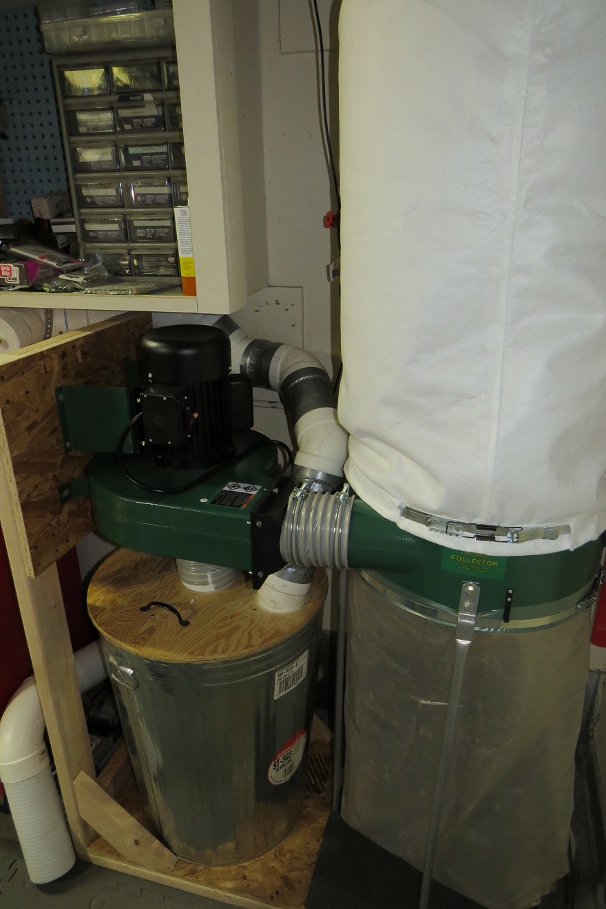

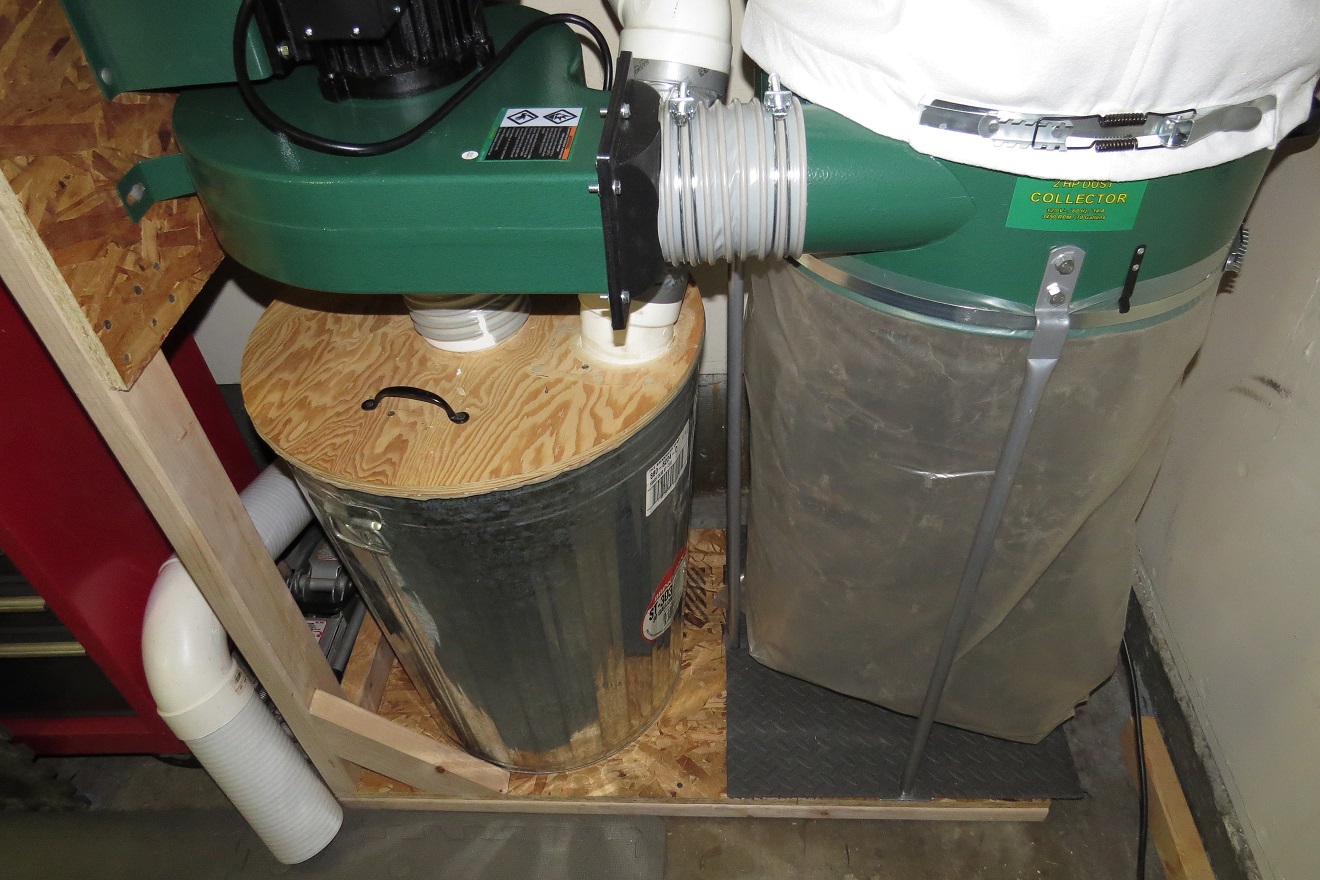

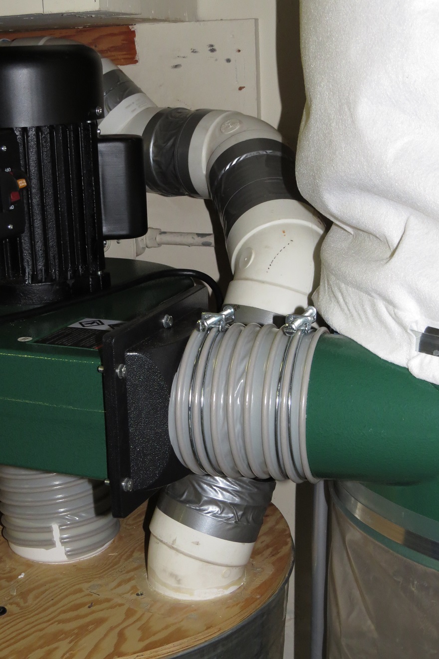

                Finally got my HF DC set up like this one, and I'm very pleased with the increase in airflow overall throughout my ducting. I haven't added the Wynn filter yet and will continue to use my old Thien baffle arrangement (which I had upgraded to 4in fittings), but otherwise I made the same framework with the same impeller positioning, etc., I'll post some pictures of the setup shortly. If anyone is interested in the dimensions of my setup, let me know and I'll post.
                  Promised pictures, attached. Although the dust collection bag is a heavy thickness, I decided to "pad" the base of the stand with a piece of foam mat. Interestingly, I believe this setup is quieter than my Delta 1HP DC.
                    Nice setup!
                    FWIW - I use a cloth bag installed over the plastic bag for protection.
