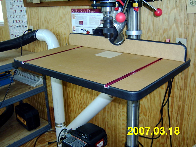

                      Hi
                      I built this table for for my drill press: Drill Press Table. It is from issue number 94 of ShopNotes.
                      Some elements of construction:
                      • Two 3/4 inch plywood pieces laminated together then topped with formica.
                      • Two T tracks for the fence.
                      • There is a replaceable table insert made of MDF to drill into.
                      • The fence is made from Hard Maple with T track.
                      • There are four cutouts to assist in clamping of the work.
                      There were more bells and whistles to the plan, like dust collection, drawer, etc, that I chose not to incorporate.
                      I am at the point in my woodworking "career" that the trial and error experience of building shop jigs, fixtures and cabinets far out weighs the convenience of purchasing the same thing. I would rather make mistakes on something for the shop that for that piece of award winning woodworking for my wife. (not that I have anything award winning yet!)
                      I can post pictures if that would be helpful.
                      Greg
