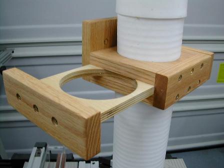

I have made several out of MDF or plywood tho' ... a 2 1/4" hole saw is almost exactly the right size for the hose end to fit snugly.
This is another I did using a hole saw and a forstner bit, I forget what sizes I used to get this one tho. (the hose actually fits on the outside of this one)
