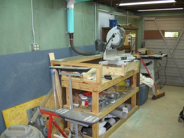

                  I mostly use mine as infeed and outfeed supports for the table saw and thickness planer, and as "extension wings" for my miter saw. The tops are a hard plastic that's pretty slippery. Despite that, you can lock the top in the horizontal position and have a pretty decent adjustable-height sawhorse.
                  Get a couple of these and your roller stands will gather dust, guaranteed. In addition to being wider than most roller stands, they're also harder to knock over.

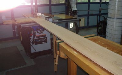

                      You can see two of them at front-center of this picture:
                      EDIT: Here you go ... http://benchmark.20m.com/reviews/Rid...andReview.html
                      Name appears to be "FlipTop," all one word. In my HD, they're in the same area as the folding plastic sawhorses and such.

                          And yes, they are GREAT! Extra supports, infeed/outfeed, etc. The tops are quite slick and lock in a near horizontal position. There is a little give so they actually tip slightly to make a ramp for outfeed use. Arrows on the top remind you of which way the stock should feed into the stands to take advantage of this designed-in feature. You don't have to be 100.000% precise on adjusting the height of these things to use 'em as outfeed supports. And unlike long rollers, they have zero tendancy to try to steer your stock if not perfectly lined up. I also use mine, with a couple quick spring clamps, to support my router table top at times... since I haven't gotten around to actually making a true router station.
                          Don't just buy one though; start with a pair at least.
