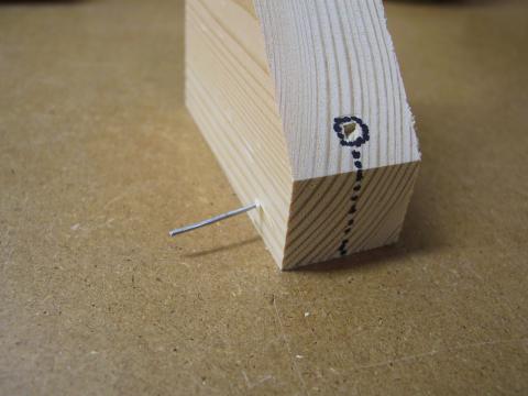

          Hey, thanks for reminding me -- time to trot out the ol' "blowout" pic:
          Dotted line shows intended path (straight down). No knots in this piece of pine, but if you follow the growth rings from the entrance point to the exit....
          Glad I wasn't holding on to the side!

            LCHIEN commented
            YES! Don't put your hand within a brad's length of there you put the gun, brads have been known to make U-turns because of grain.
