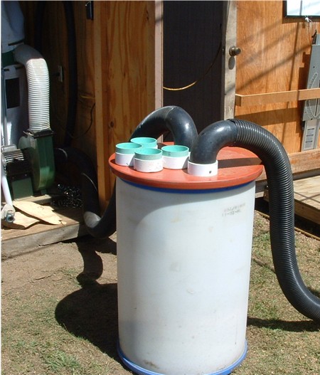

      • Popeye
        • 1848
        • Woodbine, Ga
        • Grizzly 1023SL
        This is how I did mine. The top was on a smaller 35 gallon trash can and worked fine. I just wanted something bigger and deeper. I used all 4" thin wall and you'll note some creative flange sizing.
