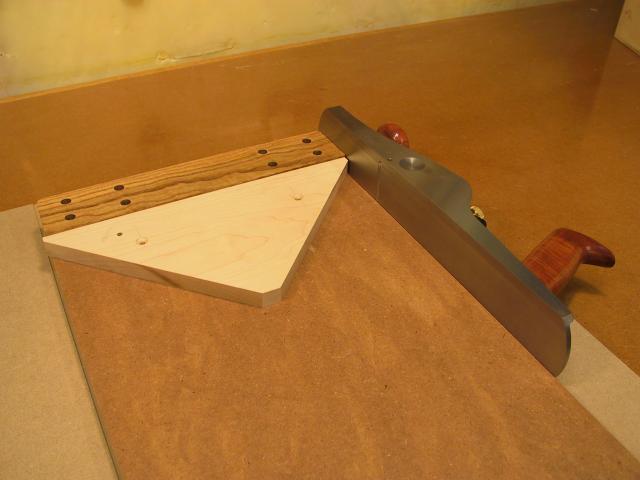

    Shooting boards are awesome!
    So simple, and yet they really put a smile on your face the first time you use one. (OK, part of that smile probably comes from the LV low angle jack. )
    When you need to tune a cross cut or a miter, you really can't beat it:

    On the next version, I think I'll swap the 1/4" and the 3/4" mdf -- why waste ~1/2" of blade?

    Mines not as pretty as yours, but I do like it. I need
    to make the 45 degree and angled setup that you've got
    going on. Those are great.

      Question from the ignorant:
      How does a shooting board work - wouldn't the plane chew off a bit off the shooting board with each pass? (sorry if it's totally obvious - I have very little hand-planing experience)

        That's the first question that went through my mind when I first saw one of these...
        There's ~1/4" or so of plane sole on each side of the blade where no cutting takes place. This portion of uncut shooting board edge is what keeps the plane in its place.
