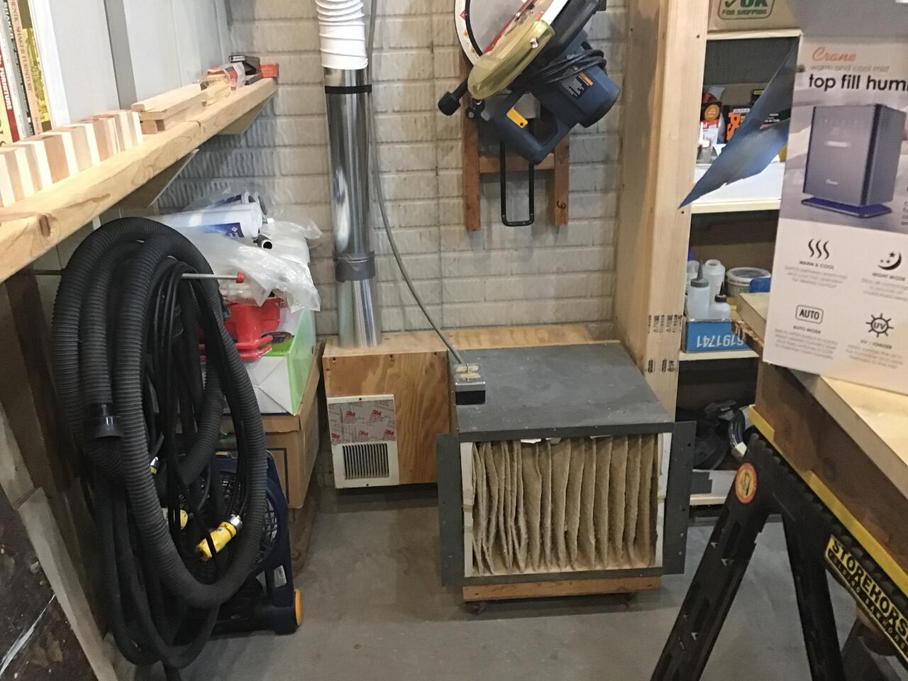

      I doubt it would work very well, but a couple of queries to the makers should answer your question. My ambient air cleaner sits on the floor in the corner of the shop and sends about a third of its airflow around the floor and the rest overhead to blow the airborne dust down. The shopvac gets the small amount of chips hand tool work from the floor. Click image for larger version
