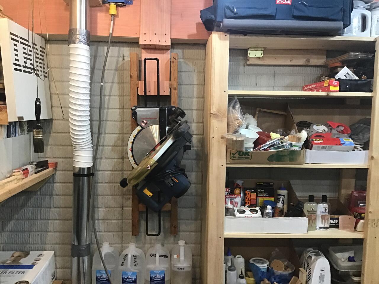

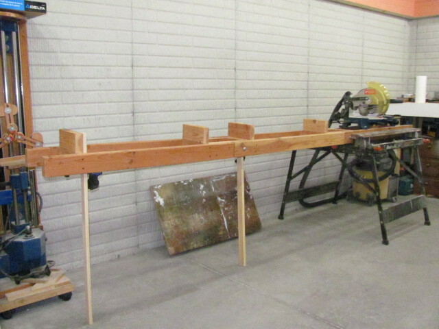

        Small shop. The CMS stores on the wall when not in use. The B&D Workmate does double duty as a support for the assembly table with a StoreHorse. The extensions store up on the wall near the joists when not being used. There's lots of setup/tear down time in my shop.

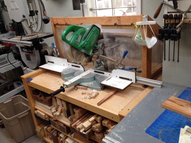

            my miter saw station dust hood does capture most of the dust, especially when I remember to turn on the dust collector. 10” Hitachi compound slider saw.

              So that looks interesting. I see you more or less have a slant top, and what is that clear vinyl enclosure? How are you picking the dust up? I see the 2.5" hose off the back of the saw, do you have a second hose into the enclosure?
ID:	853116 It’s a lexan enclosure with vinyl curtains in front. 2 1/2”
              hose to factory dust connection on saw and 6” pickup behind saw where it blows most dust. Some dust still gets out the front but not much. The 6” straight off the clearview cyclone will suck up a large housecat if it got close enough!
                dbhost
                commented
                Well, 6" considering my HF 2HP DC / Wen impeller rig isn't gonna work, I've got 5", BUT... I have no qualms doing somwhat what you did. I am pretty sure I have a 5x5x2.5 branch wye in a box somewhere. That rig would eliminate me having to re-route my DC, just change up the hood and make some minor plumbing changes behind the cabinet... (Cabinet still plumbed with 4")...
