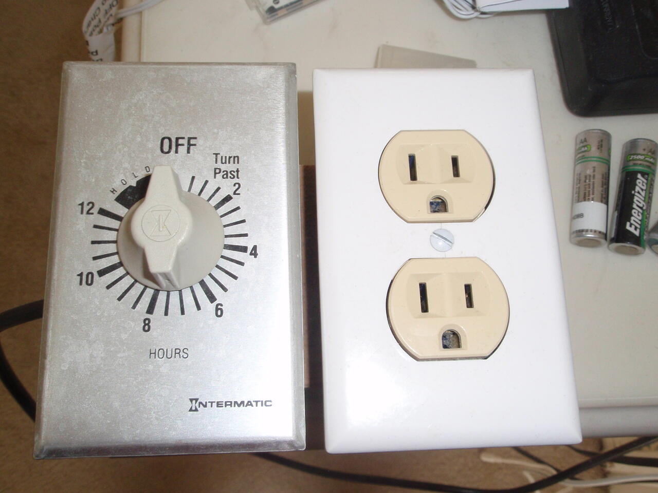

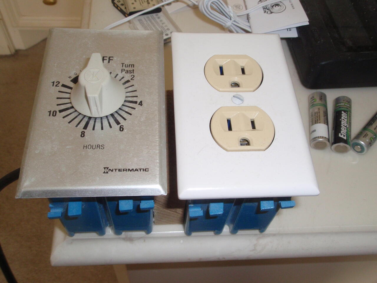

    Some years ago I made this countdown timer for my air cleaner. I used an electromechanical spring-wound Intermatic 0-12 hour timer that I got on sale but they run about $23 now. I put it in a couple of electrical junction boxes and a power cord and used it to control my air filter/cleaner - I would set it on 4 to 8 hours and work in the shop and leave it running after I retired. I use another one to limit the time for older NiCd/NiMH chargers where they can get overcharged if you leave them on too long.
    Click image for larger version  Name:	P2140839.JPG Views:	0 Size:	106.2 KB ID:	848395

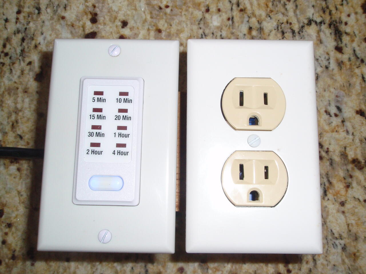

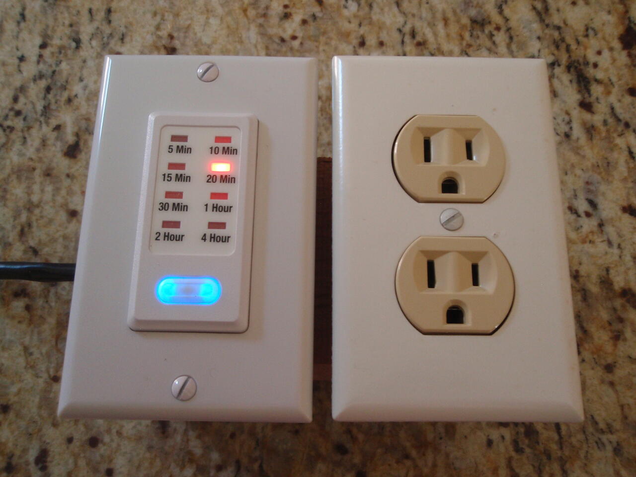

    I upgraded to one of the new countdown timers.
    Click image for larger version  Name:	P2140843.JPG Views:	0 Size:	103.0 KB ID:	848394
    You press the button to select which of 8 preset times you want.. 5 min, 10 min, 15 min, 20 min 30 min 1 Hr, 2 Hr, 4 hr. and off.
    Once you select one of the settings it turns on the outlet for that amount of time and then turns off.
    I plan to use this for glue guns and my wood branding iron because I'm always worried I might forget and leave it on. 20 minutes setting I think is ideal for those.
    These timers are only $11 on eBay and you can make the whole thing adding a plastic double-gang outlet box, a new style square duplex outlet, a duplex cover a few scraps of wire and a recycled power cord and a strain relief. Probably around another 5-7 bucks.
    I used two single boxes here because the original Intermatic timer needed its custom cover dial. so there was no double width cover that would work. This is much simpler and easier.
    I could use this timer for the air filter cleaner too, but I have relegated that to Google Nest Hub and a voice command now. "Hey Google, turn on the air filter for 4 hours!"
    No matter how you get it, a countdown timer is a useful function to have for a shop.

      I just figured out the downside of the electronic timer vs spring wound timer.
      The electronic timer uses 1.8 Watts all the time, when plugged in whether or not the load is on.
      Costs me $1.57 a year to leave it plugged in.
