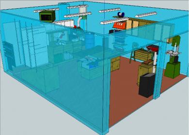

              Oh well, the intent I have here is to come up with a shop layout with LOTS of enclosed storage / organization.
              I have the book / media cabinet done, the miter saw / mortiser cabinet base is done, the drawers are a work in progress. The tool cabinets are done although there is in the image a "bridge" between the two cabs, that is simply shelves attached to the sides of the cabinets and some easy peasy plywood doors. The Drill press cabinet is designed to work with the mobile base and hold all of my drilling stuff, the miter saw cabinet holds my, well miter saw stuff, plus most hand held power tools, cords and miscellanous stuff. The saw cabinet holds table saw and router accessories, and the workbench holds hand tools and supplies not housed in the tool cabinets.
              http://sketchup.google.com/3dwarehou...c2&prevstart=0
              With this layout, I should be able to keep all of my small tools, and most supplies stored in enclosed, neat cabinets. No floundering around for where does this or that go... I have designed it with plenty of spare space... Now once this is completed, with the shed stuff out in a shed, I should be able to manage just about any size project I am willing to take on...
