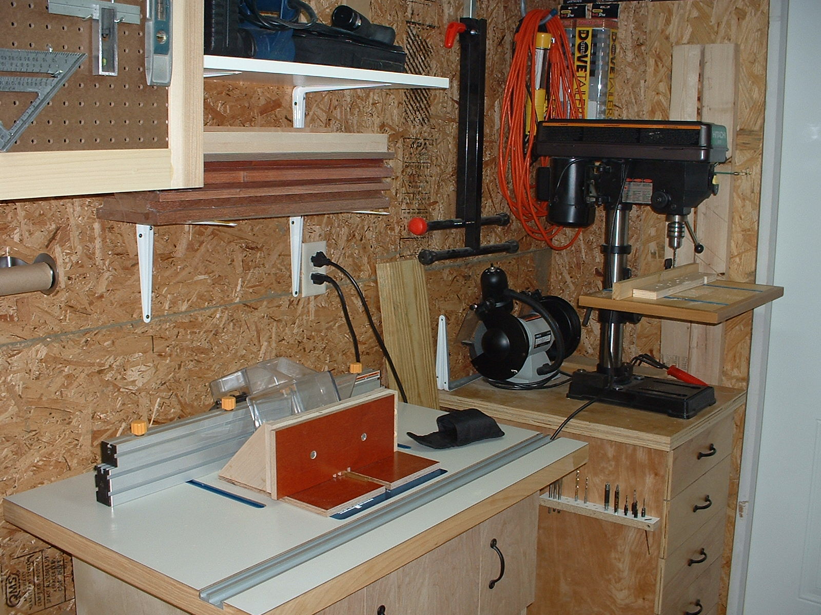

        Not the best pic but, you can get the idea.
        5 drawers in front and an inset pegboard on the back, on 5" casters for mobility.
        I believe the stand was in Shopnotes a few years ago.
          Your stand looks very good and functional. Looks like you may not have a problem with stability, but for those planning a tool on wheels, keep in mind that a DP is a fairly tall and narrow tool. It's on the top heavy side. In planning for a base, especially one on wheels/castors, the overall balance can be improved with a large enough spread for the castors for support (or counter weighted with a base and its contents).
          If the castor layout is within the confines of the concentrated weight, moving it can be a tipsy event. If a castor hits an obstruction on the floor, the top of the DP will want to continue to move. Just thinkin' out loud here (so-to-speak).

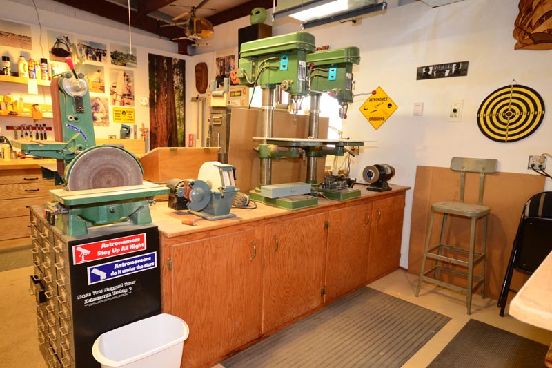

                    Since this old thread showed up, here is one more idea. Consider making your machinery stand a bit larger so it can hold two or more machines. It eliminates the metal stands that waste space, makes the stands far more stable, and provides a lot of storage. This cabinet is not on casters - but it could have been. I use plastic furniture feet so the cabinets can be slide around on the floor, for those times when I feel like rearranging things.
