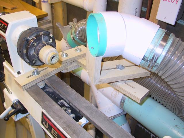

    I set up this articulated contraption to hold the end of a hose near the area I'm working. I was mostly interested in capturing sanding dust at the time, for which this works very well.
    I haven't taken the next step, which is to make a hood, partly because I'm dubious of how well it would work. I do have a DC floor sweep attachment just below the lathe.
